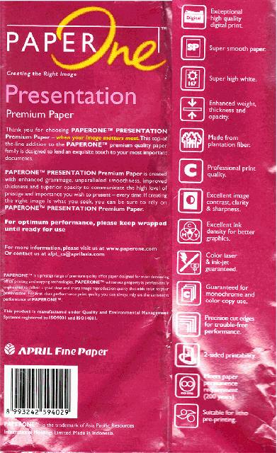

Hi stratman,Tin Ho
I am not too sure if I will be welcomed to participate here after I told u guys here that I am from overseas. Afterall, majority here seems to be from the US or other European counterpart and the inks u guys normally have accessed to are Hobbicolors, Image Specialists, Formulabs, G&G, MIS etc. Contributions of post from members who uses the same inks source as u guys did will render them to be more useful then from brand of inks that are different/not the usual from what u guys normally used.
I have no idea what is the 3rd party ink as here usually sellers repackage the ink they purchased. They may or may not get their ink from the same China manufacturers as your Oversea resellers counterpart did.
I am using this 100gsm paper which is said to be suitable for inkjet printing as well.
I don't think u can see the wording from this picture clearly. So here is the Product Specification from the website: http://www.paperone.com/product/OtherBrands_Copy_Laser.asp?rid=28
This paper is expensive. I saw the pricing wrongly and only realized that when I was paying at the cashier. It cost twice the money for this 100gsm paper from the normal 80gsm. Not slightly more than the cost of 80gsm but twice the value. Oh well...... I tried to comfort myself while standing at the cashier that at least this 100gsm paper will decrease the amount of the paper getting all warpped up when printing double-sided with inkjet.
Now my feelings just skyrock to the bottom. I still have 480 sheets of this 100gsm paper unused as I just bought it recently along the same time when I purchased the refill ink. So there is plenty of this refilled black pigment & dye inks left. I am trying to cut cost and save money which is why I now turn to refill ink and use normal plain paper instead of coated paper which is expensive here. It seems I have to spend more in the end. This is so disheartening.

lin said:
Hi stratman,Tin Ho
[url]http://www.nifty-stuff.com/forum/uploads/thumbs/2740_100gsmpaperone.jpg[/url]
I think it is so expensive because you can print on both sides, I recently tried skyhorse 90gsm coated paper that was surprisingly good, it even outperformed way more expensive HP coated paper. The prices were very good 100 sheets cost about 6.5$ even compared to HP coated roll paper that I uses to cut to desired size it's still very cheap.
The reproducible color gamut is a bit larger with skyhorse, can't tell any long term color fading because I bought it recently.

Just to clarify. My above mentioned 100gsm paper is not a coated paper. It's just ordinary A4 plain paper which is in 100gsm. That's all. But it's cost twice as much compared to 80gsm which I only realised during payment. Obviously for 100gsm, it will cost a bit more but I didn't expect it to be twice the value of the 80gsm.
Here, if it's coated paper, it would cost 5 times for the same amount of realm of 500 sheets of the 100gsm which I purchased. And it would be 10 times the cost of 80gsm (500 sheets). So it's not possible for me to buy 500 sheets of coated paper.

I am unfamiliar with your brand of paper. Because of the extreme costs of your paper locally, is it possible for you to order off the internet from a European or Asian company with paper and ink known to fellow posters in this forum?
Did the 80 gsm paper cause this problem as well? Has any paper worked well for you?
Can you trade for or get some different paper from a friend or associate and try another brand?
