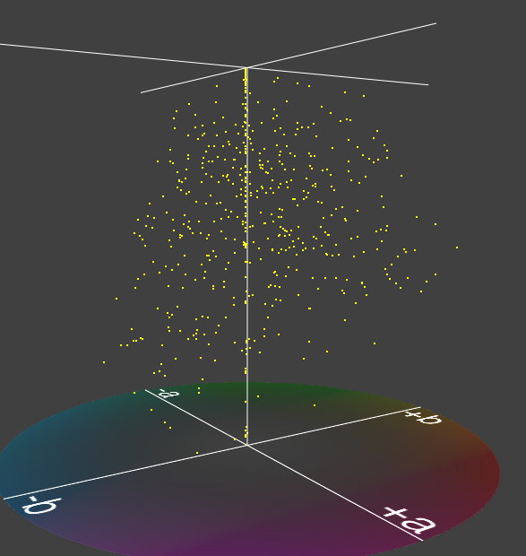

I'm trying to understand how the colors of your patch sheet are distributed across the Lab color space - where your 400 to 600... colors are located. The first problem with your patch sheet - not actually yours but generated apparently by ArgyllCMS is the patch sheet setup - you have the colors of the patches - and lots of additional colors of the separating lines between the patches - just do a lookup of total colors of such patch file - there is typically a function in image editors like 'count unique colors' , you get plenty more - something like 2850 colors which very much disturb the display of the patch colors . The Monaco Gamutworks old software can display a graphics file as a pixel cloud in the Lab space. The display is in 3D which I cannot replicate here in my posting which makes it more difficult to understand the display in 2D.
The pixels are not distributed very equally in the 3D color space - there are barely any in the darker range - L below 20 (along the vertical axis L) at the bottom.
I don't know at this time what this means - which impact it has on the data calculations to generate the
data for the various A to B and B to A files/LUT - lookup tables - in the icm profile.
Please be aware that this finding is just an obseration at this time.

Let me display @pharmacist 's 480 patch file in the Lab color space - the colors of the spots are pretty regularly distributed across the Lab display volume - yellow spots - I'm overlaying it with the gamut volume of the sRGB color space - shaded in green. Color spots of the target sheet are located at all corners and along all edges and inside the volume in about equal distance, that's quite a similar view of target sheets generated by XRite software - i1Profiler in my case.
(Sorry - I cannot give you the 3D functionality here with the Monaco software)
