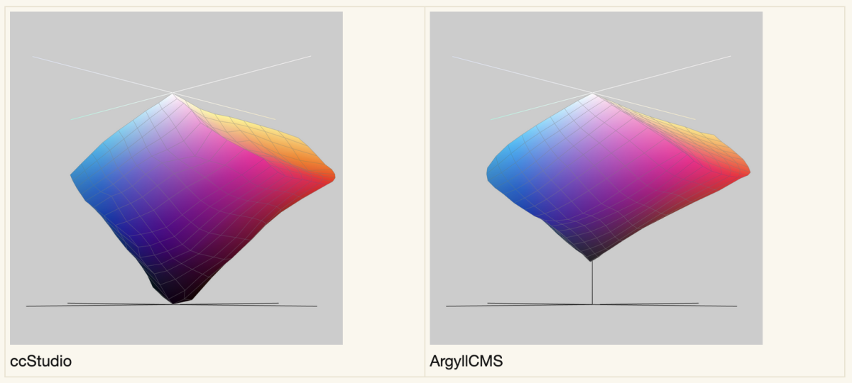

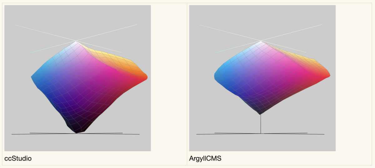

No, I cannot make a comparison with commercial software from X-rite or Datacolor as I do not own either. What I do see is that Argyll creates colorimetric profiles which give you the darkest neutral black possible with a particular printer-ink-paper combo. Deviating from neutral (and thus from the "rules" of the colorimetric rendering intent) might result in darker blacks, of course.
Now, with the perceptual rendering intent all bets are off as there is no well described standard to follow.
@OP: have you tried using the -S flag with a small percentage of gamut compression (1% or so) instead of a reference ICC profile? This might give you deeper blacks without hurting the overall look of the image too much...
6,359
7,576
The black level as stored in the profile data is the actual value as measured during the scanning process, it's a kind of raw data, and this black is not neutral but depends on the ink/paper combination actually measured.

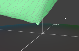

The neutral black is the point where the vertical neutral gray/L* axis (a=b=0) cuts through the surface of the gamut volume as shown in this crop of a profile display
and this neutral black point is typically higher than the abs. black point - the lowest tip of the gamut volume. Lots of users don't differentiate between these different blackpoint types. Various profiling programs let you adjust the actual value for the blackpoint - somewhere between the actual and the neutral blackpoint. This does not just affects the neutral blackpoint but the overall position of the (neutral) gray axis. I don't see ArgyllCMS to offer such blackpoint adjustment.
And to summarize all this you either use ArgyllCMS as is or use a profiling package which does it differently.

Thank you. This “lifted” black point is what I referred to in my original post.
I assumed there were settings/parameters/options for ArgyllCMS that can “drag” the black point down so the profile would become usable. I think that is the adjustment you are talking about. I really wonder how it is possible that this doesn’t exist and still everyone seems to be happy with ArgyllCMS.

This is likely a typo, both options should do gamut compression. -S1 is correct and works on both the perceptual and saturation table. The gamut in Colorsync is a plot of your measured patches and will not change with different settings in Colprof.
To check the actual behavior of your ICC profile you can use Gamutvision (free) and have a look at the RGB and simulated neutral density curves, just like @Ink stained Fingers did in some of the earlier posts in this thread.
The ccStudio plot makes no sense. It shows a combo that can reach absolute black on paper (L=0). Those gamut plots should faithfully represent the patches measured by your spectro... and you can check this: does the Lab-value of the darkest point in the plot correspond to the black patches you´ve printed on the target sheet (Spotread to verify)?
I can see how the ccStudio plot doesn’t make sense for showing the displayable gamut of my printer/paper combination. Obviously it can not print absolute black. Yet I get darker blacks using the ccStudio profile.
I create profiles not to find out about the paper gamut but to get nice looking prints. For this I seem to have to use ccStudio.
Apparently it is not possible to reproduce a similar behavior to ccStudio with ArgyllCMS (stretching the black point to absolute black, which seems to make the printer print darker darks).
Because of this I will have to use ccStudio with all its downsides (waste more paper, not being able to share the profiles). At least I get correct prints.
