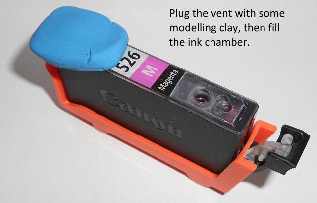

Lin, I hope you don't mind if I say this, but when refilling the opaque cartridges you can not see the sponge. Or the ink chamber.
Can you repeat the cli-8 experiment, but this time with a freshly purged and dried cartridge? You know, one that didn't have a few months to dry? And, please, cover the cartridge with some opaque tape, so you can't see inside. I bet you will see a difference in the way ink was absorbed in the sponge...
Also, could it be possible that the sponges in cli-8s are different than the sponges in cli-526s? And I'm not only talking about size. The grooves in the body certainly are different...

ThrillaMozilla said:
Tudor, Lin is correct. His point is that if you block the vent and the exit port, you cannot saturate the sponge because there is nowhere for the air to go. This is true even if the sponge is damp. It's actually the principle behind Mikling's original method for top filling. In that method, you fill the ink chamber partially and let ink soak into the sponge, as in the third figure. Then you seal the vent (so the sponge will not fill further) and fill the ink chamber.
And who wanted to fill the sponge by keeping both vent and exit port closed? He came up with that by himself and then proved that it's not a good idea.
see http://www.nifty-stuff.com/forum/viewtopic.php?pid=62730#p62730
He states that:
lin said:
Air is needed to go into the ink chamber for the exchange of air and ink to be absorb by the sponge. Even by closing the refill hole with plug at point B as you mentioned #8 and thereafter point C removing of the clay, you are not allowing the exchanging of air and ink process to take place.
So if the top fill hole is plugged and vent opened the sponge doesn't absorb ink... Does that sound right to you? How come the german refilling method works? How does the cartridge work when it's in the printer with the top fill hole closed? Magic?
I'll do a video with a cli-8 refilled using these two steps (like in the original post):
1. exit port closed, vent closed, top fill hole opened and ink chamber full
2. exit port closed, vent opened and top fill hole plugged
Maybe it will bring some light into this discussion.

I admit, my screw is big, but I have precision! :)
Check out this larger versions of the photos:
http://img803.imageshack.us/img803/8608/526acaremoveball.jpg
http://img843.imageshack.us/img843/1510/526acbremoveball.jpg
No damage to the hole.

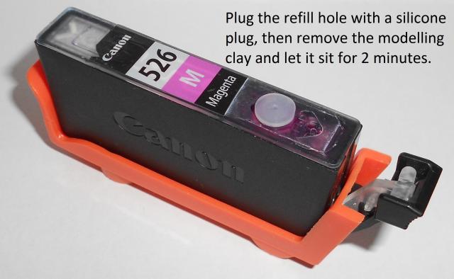

The idea was to not overfill the sponge. If you read the writing on the pictures you will find these steps:
a. Close the vent with the clay;
b. Unplug the refill hole (if plugged), fill the ink chamber and plug it;
c. Remove the clay and wait 2 minutes for the sponge to absorb as much ink as it needs. You can wait longer, but 2 minutes should be enough.
At post #9, I replied that I know you cover the vent hole is not to avoid overfill the sponge. But I explain why at post #7, why I saId you shouldn't refill with the vent/air inlet hole hole closed So Soon. By writting at post #9, Air is needed to go into the ink chamber for the exchange of air and ink to be absorb by the sponge. And telling you that your step, B and C.
. By this statement I was pointing out to you that your point from a to b. You not allowing in any stages for the air and ink exchange to take place for the sponge to absorb during refilling. Now when you go to point C, with your plug at the refill hole and clay remove, your cartridge that is on storage clip sit for 2 minutes or more, the ink is barely going to the sponge.

lin, do you have any cli-8s left that are really dry, like the one you used for the experiment? I need to know the weight of a really dry cli-8. It should not be modified (no hot glue added). Thank you!
I think we should leave things as they are, as we cannot reach a consensus. I will refill a cli-8 as in my original post and see what happens. And film it. And post it here. :)
