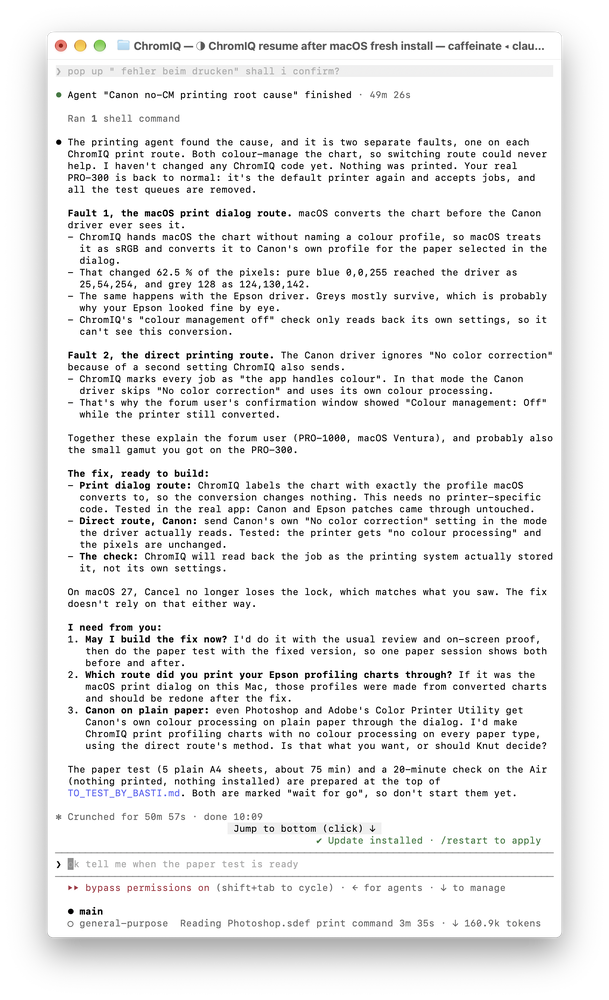

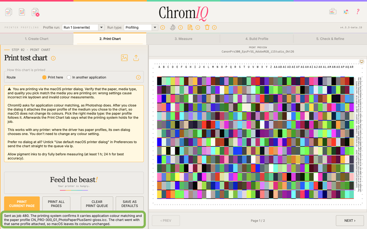

This whole app is vibe coded with the help of AI. I personally lack the technical knowledge to understand exactly how things are working under the hood. When I started this I let it analyse Adobes Color Print Utility and Apples ColorSync and tried to figure out how those apps are handling thing to learn from it - basically as you suggested. I have printed many pages on my Epson ET 8550 (because the ink costs for it are lower) and measured them with the AI agent judging them and at some point it seemed to work. Also the results were the same like when comparing them with other apps.

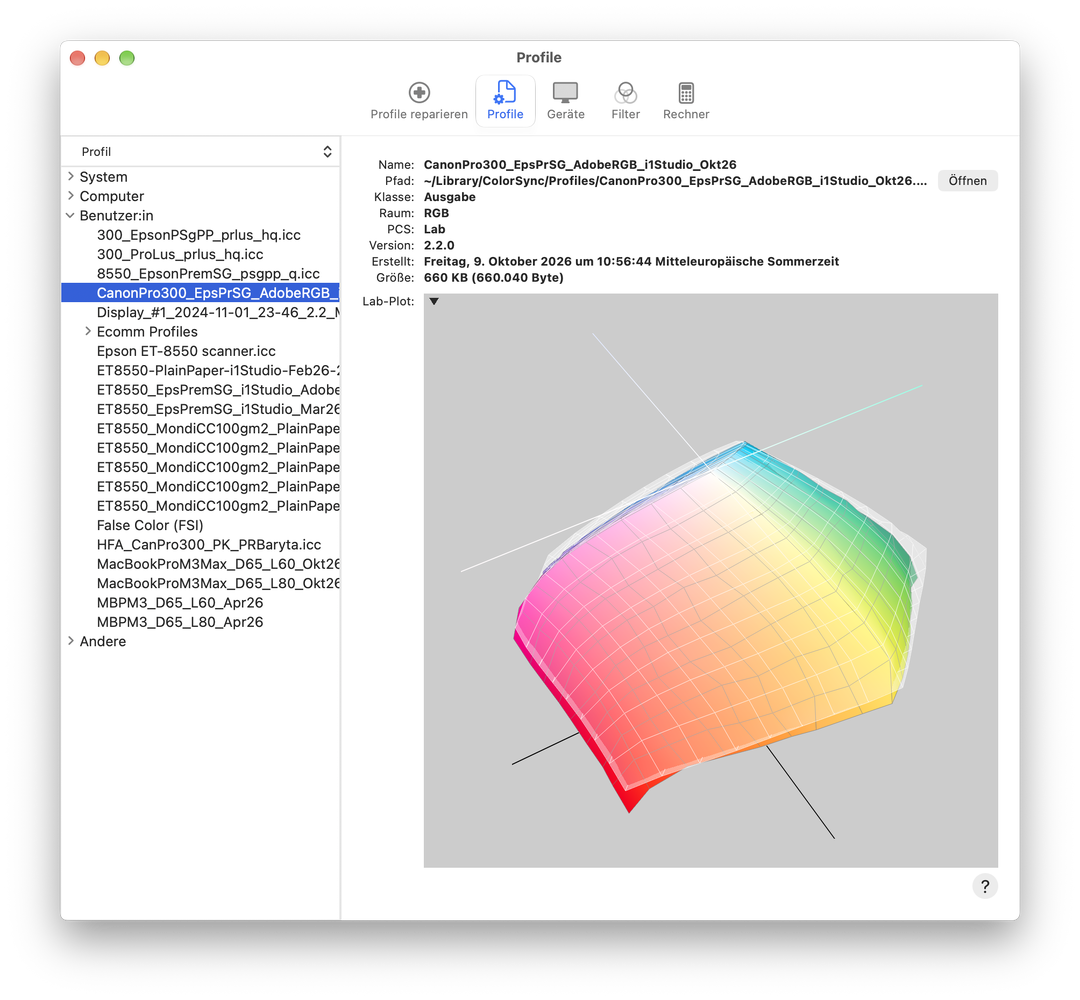

Then sone time later I wanted to create a profile for my Canon Pro 300 and had similar issues like you. The gamut analysis in the check and refine tool showed a very small gamut volume that could not be true for the printer paper combination. I tried to find the cause but got conflicting information. Also someone reported printing was working for him on macOS Tahoe. This left me confused.
But since then I have at least learned to handle the AI agent a little better so maybe another research on this might help. On discord I read a post from a person who created a mac app that is also related to printing with Canon and I asked him how he handled things to make sure the settings are really respected. He shared some information and a script that he made that checks the print job that is sent to the printer through the macOS printer dialog.
My thought was to maybe use this for ChromIQ as well. As you saw by changing the settings in preferences I had a similar thought before - just for the other route. But for whatever reason it does not seem to help…
