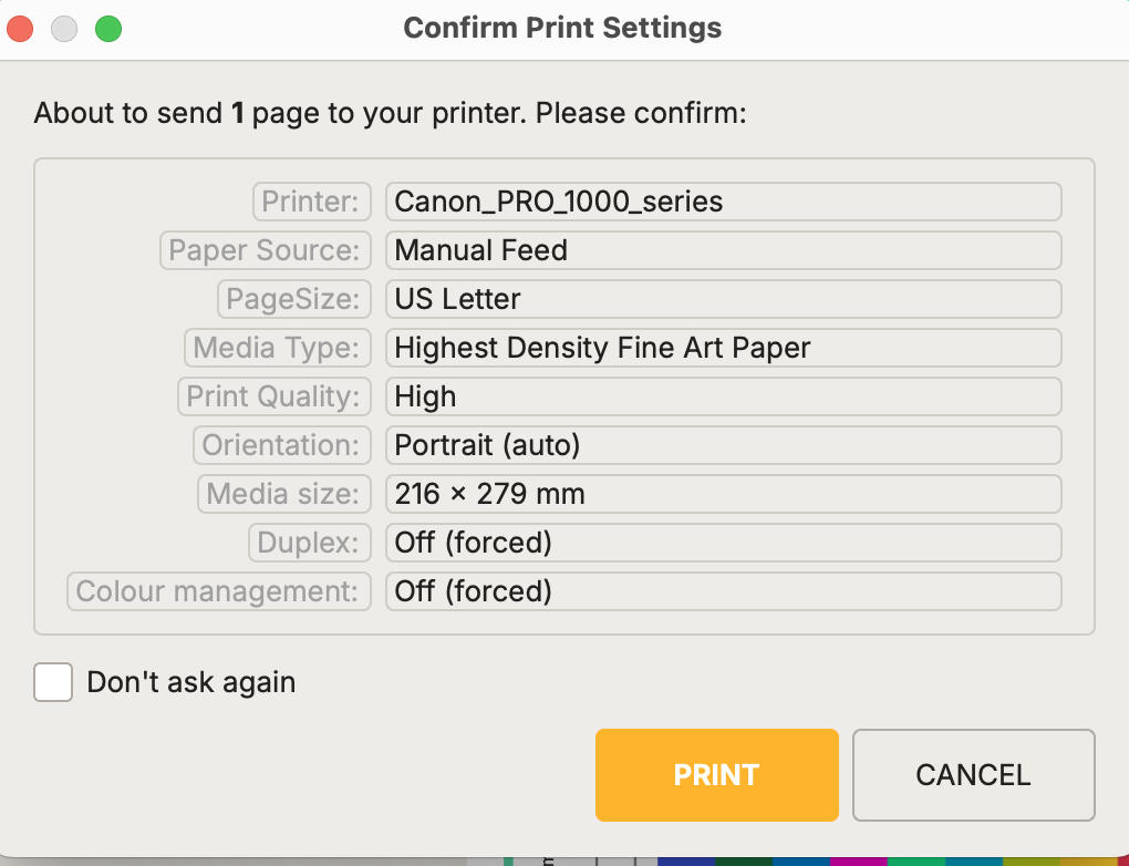

I just remembered one thing. Because of being not confident in printing with ChromIQ on macOS myself I implemented a few different options.
Can you turn off the one I have marked red and turn on the 2 green ones and then give it a try again? No guarantee though... This then does not use the Apple printer dialog but sends the commands via CUPS to the printer and might highlight other issues... But since you have printed the chart so many times now this might be a good comparison.
Printed out target as per your instructions, and it looks the same as the previous one printed out thru ChormIQ; I had high hopes this might have pointed to the issue. As it stands now, printing out thru Adobe Print Utility and Canon's seems to profile correctly, as in its soft proof and prints.
