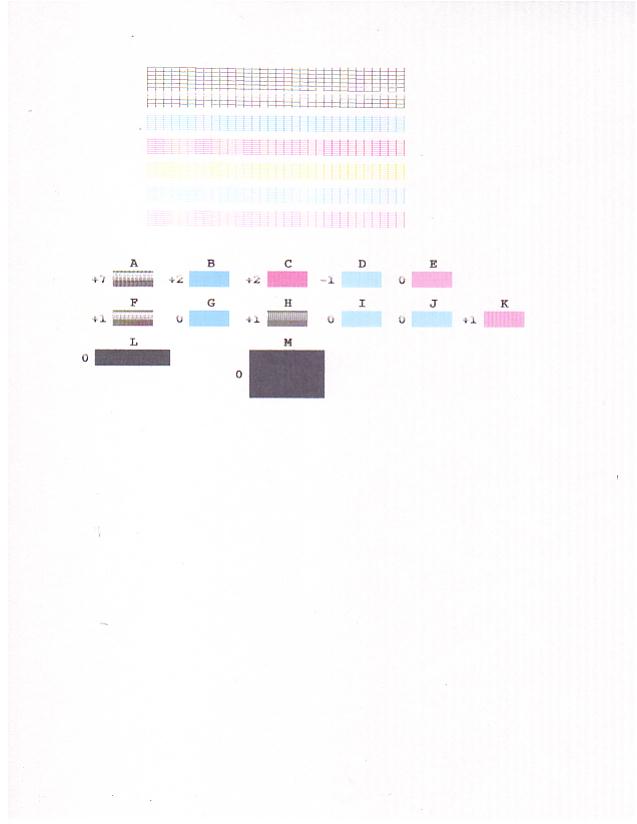

When I print, all colors work, but the black is faded on approximately every third line. I've done all the maintenance steps in the menu, so now I want to clean the areas where the ink flows.
Where are the print heads? and how do I clean them?
Thanks, KMEC

Well, I cleaned the print head, but still have problems.
I printed and scanned your email so you will be able to see the problem.
The first line of the email (first paragraph), the top portion of the
letters are faded and barely there, then the next line prints fine. The
first line of the next paragraph, the top of the letters print fine and the
bottom of the letters are faded and barely there, then the next three lines
print fine. In the third paragraph, lines 1, 2, & 3 print fine and line 4
is faded at the top and the bottom of the letters print fine, then the next
two lines print fine and the next line prints ok at the top and faded at the
bottom of the letters...and so on.
Any clue what might cause this?
I have only used Canon ink cart and never refilled, only bought new. I am
the only one that uses this printer, so it hasn't been abused or anything.

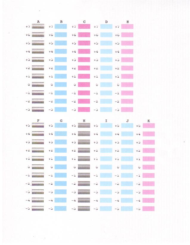

Also when I printed the Nozzle check, the "L" & "M" box printed perfectly,
but the "A" "F" & "H" boxes printed almost striped...see scan. Also the
numbers didn't print very good, but the letters did print good. Also I have
put in a new black ink cart after the head cleaning, just to be sure there
weren't any ink "boogers" in the old cart.
I've done:
Nozzle check - twice
Head Cleaning
Head Refreshing
Align Print Head
Roller Cleaning
I hope I have provided sufficient information, but please feel free to call
or email any additional questions.
It's really puzzling as it worked perfect last Sunday then Monday it began
printing like the example.
Again, Thanks for any help you can provide.
Here are the first images.
Nozzle check;

To KMEC;
Thanks for the wonderful pictures. It shows me that you know
what you are doing and believe me this is very important when it comes to
following instructions and getting things done.
The answer is very clear. Looking at you nozzle check, the problem is that
the lower portion of the Black nozzles are clogged up and can't get any ink
through them. When you say you clean the head, I assume you mean you
followed my instructions and rinsed out the ink in the sink and then dried
the head with compressed air or a blow dryer. It would have been good to
see a sample of the nozzle check before and after the cleaning to see what
improvements were made. It seems that your clogs are a little harder that
just standard clogs. So now we have to do some more serious cleaning of
the head.

The very top black matrix is the absolute best test of the printer.
Printing other things, like pictures or letters while the nozzle check is
not good could damage the head. The matrix print starts by all nozzles
firing at once to make a vertical line. Then the entire nozzle bank is
divided into 10 groups of 32 nozzles each. The first nozzle in each group
of 10 is fired continuously for about 1/8" and this produces the first set
of horizontal lines. The all nozzles are fired again to produce the 2nd
vertical line. After this the 2nd nozzle in each group of 10 is fired for
the next 1/8". This is repeated towards the right until every last nozzle
has fired. When you look at the results, especially with a 5x magnifier,
you can see the results of every nozzle in the printhead. This is why this
test gives you the best information. The same is done for the colors.
