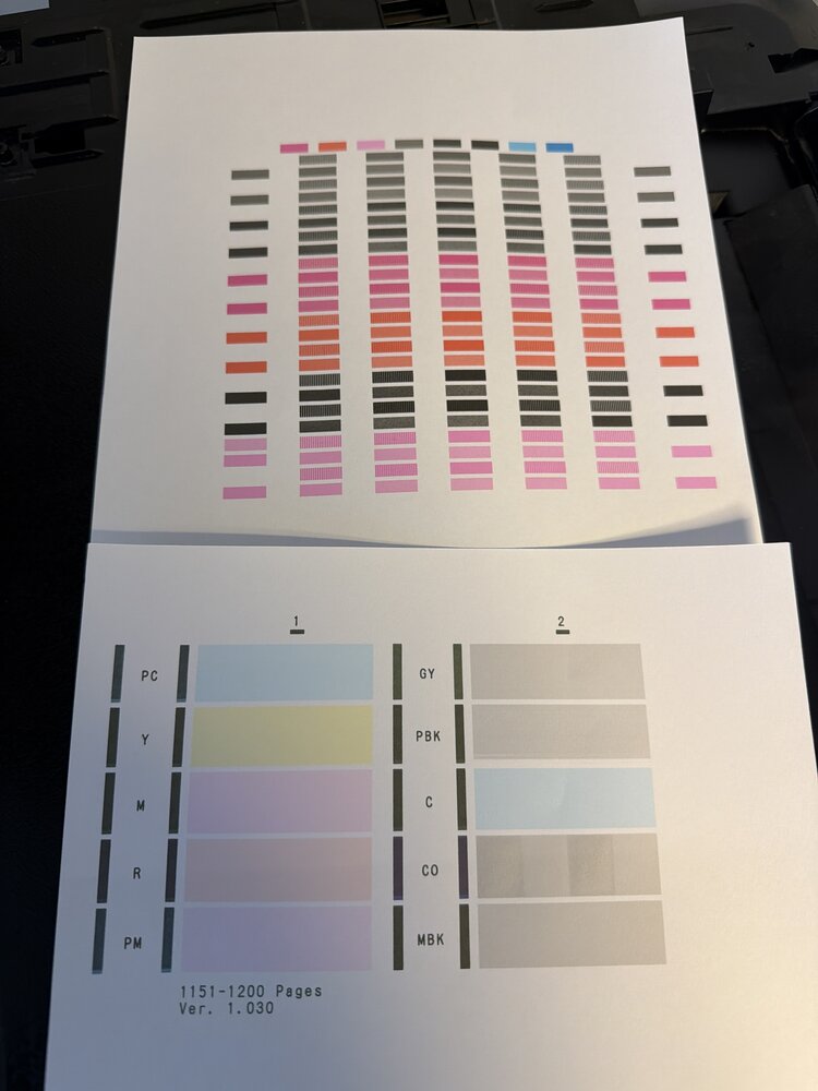

No one can fix a Canon print head, not even Canon Inc. themselves..:(
Hm, my theory is that my fiddling around with cables and connections with multiple power offs and ons might have done something with the eeprom on the print head, so i want to take a Peek at it to see if there is any lockouts activated in its programming.
the printer works fine i think… if i take out the printhead, the error goes away so i guess its the head that is broken so i figured it’s worth a try reading the eeprom 🤔

The B200 error is sometimes intermittent before becoming permanent. That's why cleaning or other procedures sometimes seem to repair the printhead.
I see, I’m cleaning and cleaning, so far no results, so far it seems to be permanent or atleast persistent.
But I’ll keep going 😁
