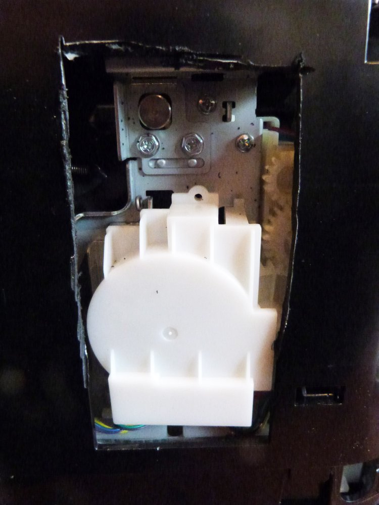

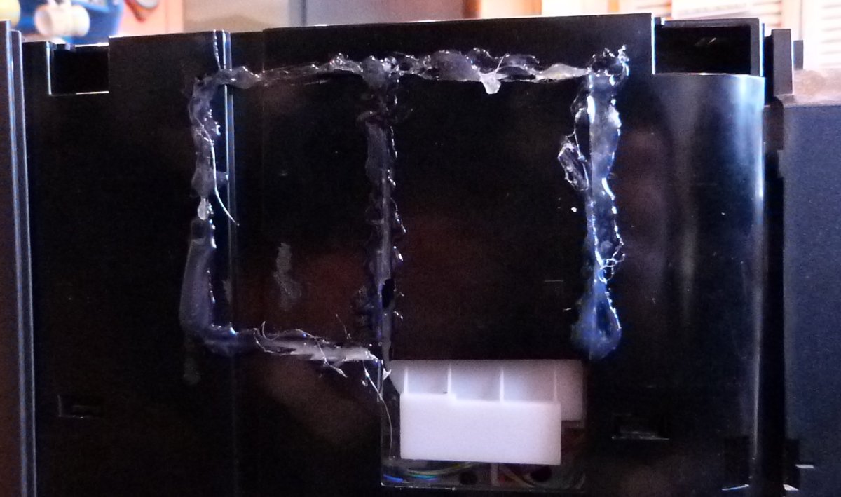

Sometimes when the printer is left off for a while (Unplugged) it will start up normally when powered on again, so try raising the top cover before switch on and listen and watch to see if the head moves slightly, when it does pull the power lead out of the wall quickly.. That’s one way..
The other method that I used was to remover the right side panel from the printer and cut a hole in the side of the frame to gain access to the gear that controls the locking catch that holds the print head on the purge pads.
When finished I hot glued the sidepieces back in but that was unnecessary because the side covers up the hole very neatly..
I used a Dramel tool for cutting..
P.S. Cleaning won’t work, you’re going to need a new Head..
View attachment 13867 View attachment 13868 click to enlarge..
You sir, are the best!!! I just got it unlocked by doing the same thing and replaced the printhead and issue fixed :)
