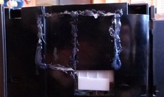

I bought a second hand Canon Pro 10 (500 prints). I managed to print about 24 4x6 prints. I have been getting the B200 error. I have tried pressing the power switch for a while before plugging it in and it worked many times. My mistake was every time I got it to work I got so excited I went on printing some more until I got the error again and again hoping it will never come back. Now, it looks like it's never going away. I would like to try and clean the head this time hoping to revive this machine as the prints are great.
How do I get to the printer head when the machine is now not budging?

Sometimes when the printer is left off for a while (Unplugged) it will start up normally when powered on again, so try raising the top cover before switch on and listen and watch to see if the head moves slightly, when it does pull the power lead out of the wall quickly.. That’s one way..
The other method that I used was to remover the right side panel from the printer and cut a hole in the side of the frame to gain access to the gear that controls the locking catch that holds the print head on the purge pads.
When finished I hot glued the sidepieces back in but that was unnecessary because the side covers up the hole very neatly..
I used a Dramel tool for cutting..
P.S. Cleaning won’t work, you’re going to need a new Head..
