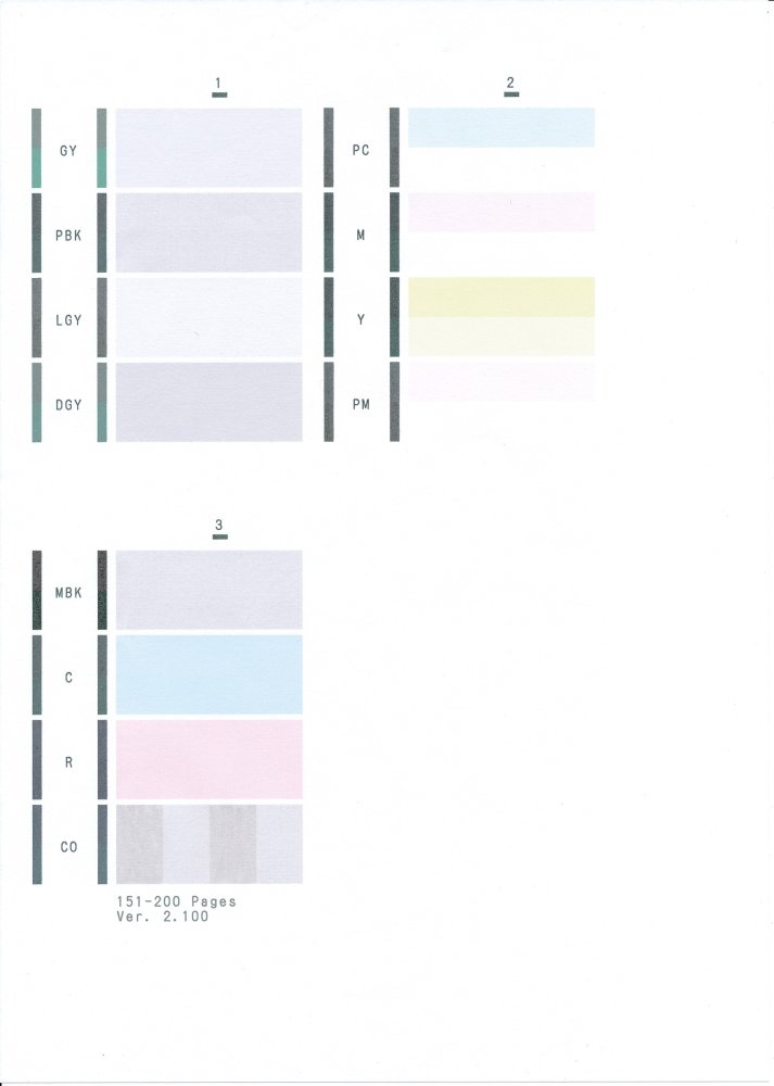

I am having a similar problem to @sallor on print group 2, except that the first band of each color is good, but the second, lighter bands are missing for three colors, but not the Yellow. I have tried cleaning group 2, deep cleaning gorup 2, system cleaning, leaving for 24 hrs and trying again, but would appreciate your advice on whether this is a clogged head, or an electronic issue. I assume its just clogged as I had not used the printer for over a year due to work/studies.
I'd appreciate any input - should I dump the PRO-1 and buy new, or carry on cleaning ?View attachment 12956

Aologies, I've been searching for answers for so long!
I moved house in January and the printer basically sat dormant for probably 6 months. When I printed an image I noticed that it seems to be missing the yellow channel, then when I printed a photo it seemed to be missing the red channel, but basically pictures are coming out and the colours look wrong. In places photos look black and white.
I've attached the nozzle test page but it's basically the same issue - the second half of each of the colour blocks is missing. I'm also getting intermittent banding showing up which you can see on this sheet.
Am I right in thinking this is new print head time..?

And we’ve been here all that time..
It’s quite possible that you have already damaged print head by trying to print images and photos on the printer before you had run a nozzle check after such a long time laying ideal.
You could try running one single head clean and then another nozzle check, if no improvement then try a deep head clean followed by another nozzle check, now examine each colour for improvement carefully, they all should look like they do in block 3.
block 3.JPG click to enlarge..
If they are still missing one half of the colour segment like you have in block 2 then a new print head is the only way to get the printer back working properly once again.

As Hans and Franz of old Saturday Night Live would say... Hear me now and believe me later...
While there is evidence of clogging in the nozzle check, it is a metaphysical certitude the symmetrical straight line missing lower half of the color stripes in bank #2 are due to an irreparable failure and not clogs. No amount of cleaning will resolve it.
