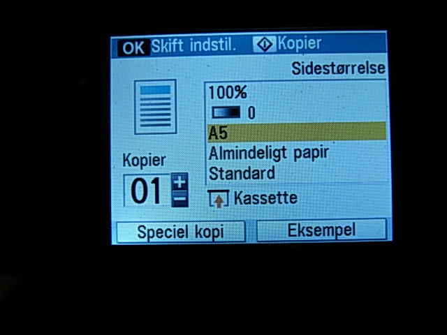

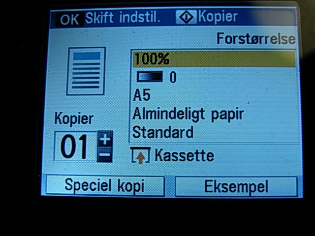

The problem with the A5 setting instead of A4 setting when using the machine as a stand alone copier, could be caused by an operator error instead of an electronic error. I deliberately changed the setting on my MP540, that uses same menu structure as the MP620, from A4 to A5 in the copier menu, and got exactly the behaviour described by barfl2.
So barfl2 I guess your printer display looks like this when selecting copy except for the language being English instead of Danish, click to enlarge:

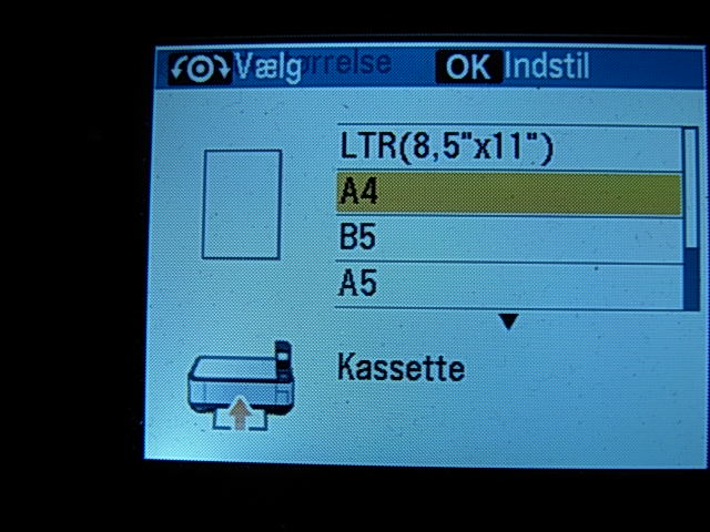

Use the arrow down button to highlight "A5" and press OK to change setting. This might not seem logical, but in this case OK confirms that you want to change a setting. click to enlarge:

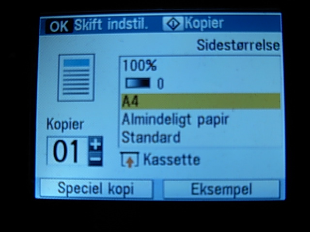

You now get this menu. Use arrow up/down to navigate to A4 and click OK to confirm. click to enlarge:
Now click the back button, and your copier menu should now be back to normal, click to enlarge:

Thanks PeterBj for your post and instructions. Before visiting the Forum this morning I tried resetting the printer to factory settings via device settings and this restored the full A4 copy facility. However I wish to stress that the A4 symbol was showing in my first copies. It was only later when I was trying zoom, fit to page etc that I noticed it was missing. I was getting the margin error shown in my attach
