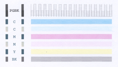

Canon mx870 only printing alternate strips

Hi John, When you have one or several clogged nozzles, the grid will have sections of it missing sporadically, but when your missing segments in parallel straight lines, this is caused by electrical failure due to over heating from poor ink flow.
The link you posted is for a refurbished print head and not a new one, mostly these are usually still faulty, it just all depend on where you get them from, you may have more luck with this site, but I can’t give you any guarantees...

Just out of interest, how can you tell it's not a clog in part of the printhead?
What are the risks in buying a compatible printhead such as this:-?

It is most likely an electronic failure, and also a lot of dirty/clogged nozzles. But it might be serious clogging only, then cleaning the print head might bring it back to good working order. But cleaning the print head outside the printer using water or cleaning fluids might actually create an electronic failure by leakage current caused by water or other fluid left where it does not belong.
Here is a print head that looked like it had suffered electronic damage, but it was clogged and could be saved by cleaning. Also see this thread and specially notice this post. The extended nozzle check suggests the MG5150 print head was damaged electronically, but it only was severely clogged.
A typical nozzle check showing electronic failure in the pigment black is here, notice the clean and "geometric" look of the nozzle check:
If you decide to buy a new print head I strongly recommend getting it from CRC Tasktron. The print head you linked to clearly is used. Notice the pink spot on the white ceramic plate. It is caused by leaking magenta ink. Clearly this print head is not new. As The Hat also mentioned it is "refurbished", not new.
