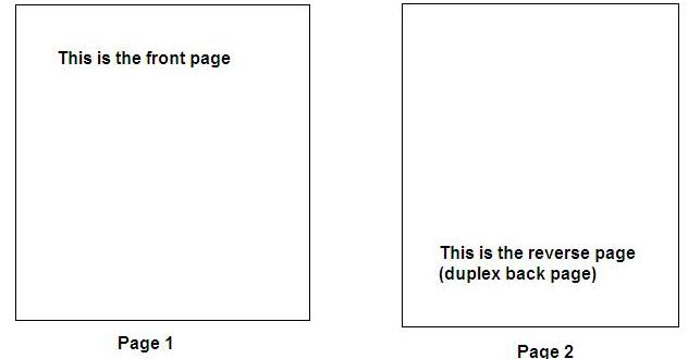

As I said, (for normal printing and not copying function) as long as plain paper mode is selected and grayscale is selected, despite duplex printing, it uses pigment black on the duplex page. Any matte paper, high resolution paper & Photo paper mode, they will use dye ink from the CLI-8 cart.
Pls try these test on your printer and see how it goes for your printer. Create a word document, with the Page 1 (front page) text on top and Page 2 (Reverse Back Page) text on the bottom (as show in the below picture). Print out with these setting on a A4 plain paper with Pigment Ink on the PGI-5BK (or rather the bigger cart). If you have refilled the PGI5BK cart with dye black previously there may be leftover dye at the nozzle channel. So pls perform a deep cleaning for the pigment black cart, and printout several pages of a full block of Black purge print page using Plain Paper mode & GrayScale setting before performing the test below. This will ensure the ink channel at the PGI-5BK at the printhead is all cleared of any dye ink.
Test Setting for normal printing (not Copying function):
- Plain paper mode,
- select grayscale and
- duplex printing.
- Have Pigment Ink for the PGI-5BK
(Pls do not use any HP Bright white or colorlok plain paper as I am not too sure how these paper will affect the test result. Ordinary Copier Plain paper will do 70/80 gsm will do).
Click to enlarge picture
Let it dry 5 mins or more whatever time/days you think are appropriate, (you may like to cut the A4 paper into half horizontally) run the printout under tap for a 1 mins. Remove the paper from the tap and observe the text on the duplex page, now let the paper dry. What do see on the reverse duplex page? If it only uses "yellow, cyan and magenta inks" on the reverse duplex page as you have claimed, all the black text printed would have bleeded/faded/washout (depending on the amount of time you run it under tap).
Now let assume someone claimed that the duplex page had mixed of pigment & the composite dye ink CLI-8 cart, what would happened to the above test. If there had been a mixed of pigment ink with the composite dye for the reverse duplex page, you will see that the surrounding the black text would show sign of bleeds despite the black text is not totally washout, that is because of the nature of these ordinary dye ink & the way pigment behaves (water-resistence). If the pigment ink alone was used on the duplex page, the black text will not show any sign of bleeds of text but appear rather sharp. So if you want to just test to see if pigment & composite dye ink was used on the duplex page for plain paper mode & grayscale for black text printing, pls do not soak the printout in tray of water until all the colors have run out. Because all that you need to catch is the color bleedings of the ink (dye ink). Couple of mins 1 or 2 should be enough.
