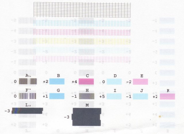

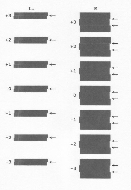

Please help me. My MP730 having a major vertical head alignment problem. It started after I forgot to close the lever on the print head after replacing cartriges and closed the printer. It tried to move the print head and stuck. The noise was terrible! Here are the scans of the nozzle check and the vertical head alignment.

Ok, now that you have the problem, what are the other symptoms. I would assume that the printing from left to right does not match or line up with the printing from right to left. Head alinment is only meant to take care of microinches, and it looks like you caused the drive belt to skip about 1/8". The bad news is that you can't get at the drive belt without taking the printer apart. If you've seen some of my other posts on this web site then you know that this is a very difficult job. The Service manual says the carriage position is initially determined when the carriage is driven against the right wall or stop. This is where the photo cell in the Carriage asm detects the large black dot. This is home. Once home is found, all horizontal position is measure or determined by the timing strip.
You just missed my MP730 Repair Manual sale on eBay. This manual is a do it yourself guide on how to disassemble and repair just about everything inside the MP730, or most other Canon printers. This is done with high resolution digital photos of each and every step and since the Manual is in PDF format you can enlarge the Digital images to 500% and see all the details very close. I also include the Canon Service Manuals, Parts Catalogs, Software & Drivers, Color test print images, and instruction on how to modify your ink carts for refilling, cleaning printheads, etc. I think it is a great bargain at $25 plus shipping.
Now back to your problem. The drive belt is easy to take off and re-position the carriage, but you have to get the entire carriage asm out of the case. There is a photo dot on the Film timing strip that passes through the back of the Carriage Asm, and this dot locates home for the carriage. Normally there is no alignment since the carriage positions itself via the timing strip. So I'm thinking something must be bent. Obviously the printer still prints OK for things like the nozzle check so that says the timing strip is still working. I'm sorry to say I have not seen this problem.
If you know how to go into Service Mode, do that and print the Service test print. This has alignment marks that can tell us what else may be wrong. Search this forum for "Service TEst Mode" and you should find the instructions. If you have any kind of test chart, print that and upload the data. This will show us more information on what is happening.

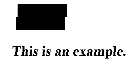

Sometime accidents do happened that I forgot to switch of the main power source to the printer (I wouldn't advice un-plug the power cord. All it takes is to switch from the power socket. Not referring the printer on/off button though). As I normally do disconnect the power so I didn't take note that I hadn't done so. Therefore I wasn't mindful that lever was up and hasn't been locked yet. Just when I was going to lock the lever after putting in the printhead & cartridges, the carriage moved to the parking zone so fast before I could do anything and it slammed real hard when it hit the roof which the automatically locked the lever. I closed the printer cover since the lever was locked by this incident.
I should have opened up the printer again and ensure that the carriage do sit properly before I start printing. The printer produces loud grinding noise when I was doing printing and throw the carriage unit error alert. I resit the carriage unit thereafter, however since then, the printing was always out of alignment.
Didn't think you will reply, I thought the drive belt was the brownish transluscent belt as there was 2 black dots at both ends which I initially thought it might have some role to play in regards to the alignment.
Well, my printer has been left unused/unable to use for 2 weeks as the oversea seller had shipped out wrong items and had gone missing and unresponsive to any form of contact to resolve the wrong shipment. Now I can't do any printing further to diagnoise and resolve it further. So below is a drawing illustration of the printhead misalignment for the moment from what I recalled from printout which I threw away already. Quite like what the thread starter, sxd is experiencing.
The top block depict the printout from the head alignment. The bottom text depict how text appeared during normal printing.
But like what you said, can't do anything to it as it requires the removal of the printer assembly to adjust the driver belt.

This could be caused by a damaged/dirty timing strip, as mentioned in post 2 of this thread. Also see (http://nifty-stuff.com/forum/viewtopic.php?pid=15610#p15610).
A damaged/dirty timing strip can cause the printer carriage to sense a different position in each direction, and to therefore offset the printing when the carriage is moving in reverse. Note that your nozzle check patterns (which are printed in a single direction) do not show the problem.
