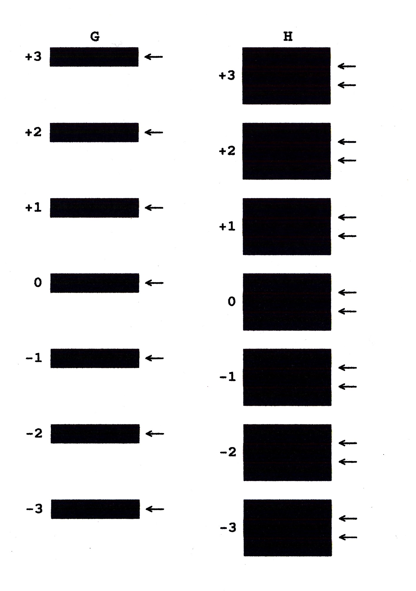

Anyway, after thinking long and hard about the problem,... it is not a "Vertical Alignment" problem. It is a "Horizontal Timing Problem". While the nozzle check pattern seem good enough, the black sections show left to right misalignment. The cause of this is that the nozzle patterns are printed in one direction only,...right to left. The black bars are printed in both directions as is the heal alignment test.
To print at a specific location from the edge of the paper, the logic counts the number of lines on the timing strip as it moves from home. It knows what the count should be going from right to left. Once it gets there it starts the print. Next the printhead has to move all the way to the left and start backwards. Again the logic card counts the Timing marks and clearly there are an exact number. When it gets to the correct spot, it starts the print again. The Bars are printed in 3 passes, first right to left, then left to right, and finally right to left again. So if the count gets off for any reason, the pattern will be skewed. When you look at a line of text that is printed in black only, the text appears to be split in two pieces and shifted.
The answer is there is clearly a timing problem difference from left to right, which was produced by the jamming of the printhead carriage ASM.
So what is the problem?... The answer is the logic card is missing "One" timing pulse in the count from right to left. It is totally possible that the Dot on "Lin's" timing strip could cause this. So as the carriage moves from right to left, one pulse is missing, one count is missed, and the printed image is delayed. It is probably more than one count as the dot is large enough to wipe out the signal from several timing marks.
A second possibility is that the sensor in the carriage ASM has been shifted, but this seems very unlikely. The logic counts the timing marks from the large dot on the right which is the home pulse. If you look close at the timing marks, they are about 200-300 lines per ink.

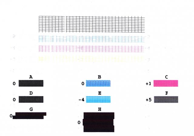

lin,...I think you will be please to hear that I have found the solution to your problem. My last post was correct and I think that Grandad35 mentioned it first but it is still the same problem.
I have had another printer waiting for repair for almost 6 months,..I've had so much to do I just couldn't get around to working on it. Anyway I finally took it apart and cleaned it and put it all back together. This is not the easist as this is one of the Canon F30 multifunction printers and to take one of these apart is a lot of work. Anyway, after putting it back together and cleaning the printhead and adding new ink, I powered it on and ran a cleaning cycle and then printed a nozzle check pattern. Here is a copy of that picture.
If you look close you will see several things. First there is a Horizontal shift in the black bars, which is the same problem you posted as Vertical Alignment. It looks just like your pictures. The second thing you will notice is that there is a complete dropout or void of black print about 1' in from the left on the Black matrix pattern.

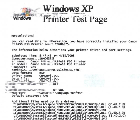

I also printed a standard Windows Test print and here is the result of that print.
Look close at this print and you will see "Smear" in the very top line and in the 1st sentence as well as have way down. You should also note that every other line does not end in the correct place. So it seems like there is more than one problem.

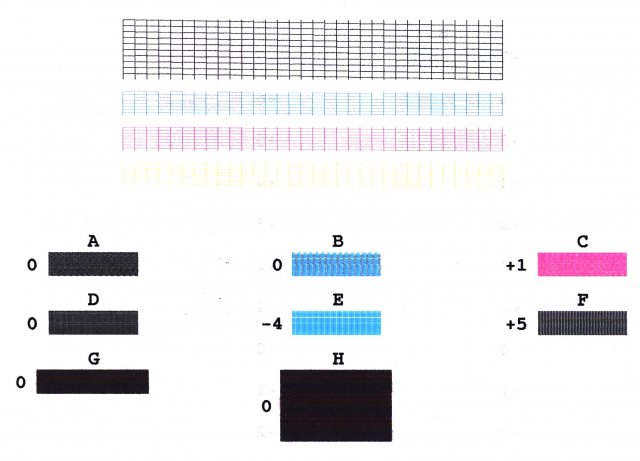

I openned up the cover of the printer and inspected the timing strip and the belt. The belt looked fine and at first look the timing strip looked OK also. But then I used a light and tilted the timing strip and I found the problem. There were several sections of very transparent grease of finger prints along the timing strip. When I initially clean the printer, I did not see these at all. This is another lession learned. From now on I will know how to do a much better job in examining the timing strip.
As I have mentioned before, and problem with the correct detection of any timing mark will cause some kind of print problem. There were seveal spots of very bad grease "Film" on the strip. If you held it flat they were no visible at all. If you can tilt them back and shine a bright light through the strip you can see the grease or smears. Now it is very difficult to do a good job of cleaning the strip for a F30 because when the cover is open there is only about 6-7" access. Anyway, I used a "Q" tip wet with Windex and gently wiped the timing strip, front and back, for as long as I could reach. Each time I moved the Carriage out of the way. I finished by drying the strip with a soft tissue. In doing all of this you have to be very carefull or the timing strip will come loose from the attachement at either end. Once I got it done, I printed several more test prints and here is the nozzle check.
As you can see the black bars are not back in the correct position, and the gap in the Black matrix print is gone. The printhead still has many clogged jets in the Cyan and magenta but that wil get fixed later. Next I printed the "Alignment test" which is shown next.
As you can see, the alignment is pretty good. However, if you look really close you will see there is still some very small shift in the printing. It is probably another very small smear somewhere on the timing strip that I could not reach. I'm going to have to take the printer apart again and do it right this time. Anyway here is another Windows test print to show how the initial problems were fixed. Like I said there is still some very small timing but it is hard to see. I was able to blow the image up by 500% and it is easy to see at that magnification.
