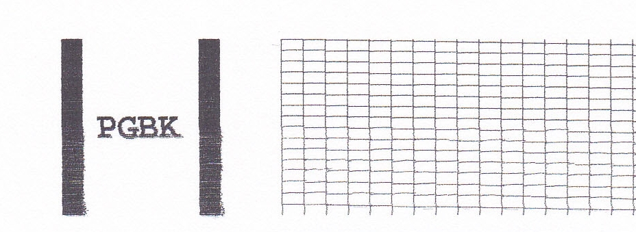

Your nozzle check has improved much by the print head cleaning, but there is still a problem with the lower half of the PGBK. You could try to repeat the print head cleaning to see if there is a further improvement. Make sure the print head is dry before putting it back into the printer. The tiniest amount of water trapped behind the ribbon cable or the circuit board on the back side of the print head can create a short circuit that not only ruins the print head, but also the logic board, making the printer a total loss.
Here is a crop from your latest nozzle check, showing that there is still a problem with PGBK:
If the timing strip is clean, then the the printing problems are likely caused by the PGBK nozzles producing a "fuzzy" print, see the lower half of the vertical rectangles and lower half of the grid. So more print head cleaning is needed.
To keep the print head in good working order, a proper function of the purge unit is vital. As the cartridges and ink seem to work well in another printer using the same type of print head, I suspect there is a problem with the purge unit. Here is a test of the purge unit.

I have never encountered this many nozzles having this problem at the same time, but I always assumed that the nozzles were firing properly (as they appear to be in this case) but that the ink droplets were being misdirected as they left the nozzles and started their flight from the print head to the paper 1 or 2 mm away. Careful mechanical cleaning of the bottom of the nozzle plate using alcohol and light fingernail scraping usually cured this type of problem for me. Is there a safer way to clean crud buildup from the bottom of the nozzle plate at the nozzle exits?

I think gently blotting, not wiping the print head underside on a piece of soft paper like a paper handkerchief moistened or wetted with a window cleaner with ammonia is the best way. Repeat as often as needed until the print head underside is clean.

Ive just done that, but the nozzle check is getting worse:mad:
The purge pads are working.
