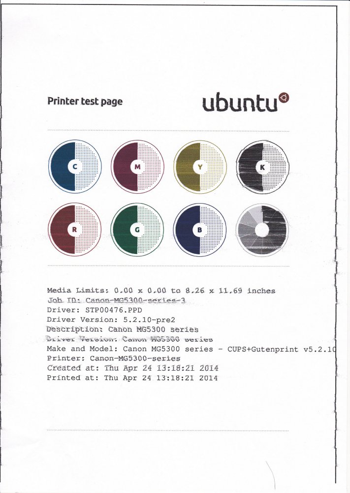

Hello, my printer has big problem with black vertical lines. You can see a actual printing result in the attached image.
Notice that the problem mostly occurs with black. It gets better when i rise the printing quality, but it is still far away from good. The attached image was printed with medium quality.

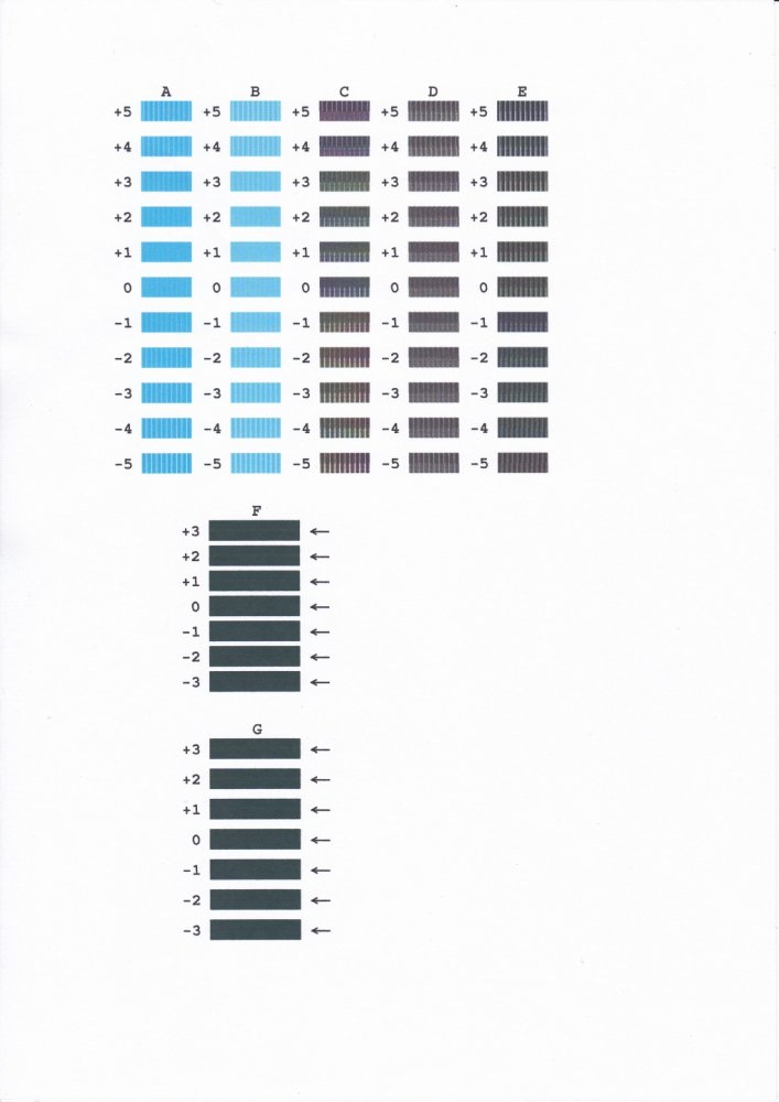

Priting head align doesnt fix the problem. Ive attached an image of the manual printing head align. In column C no field looks good.

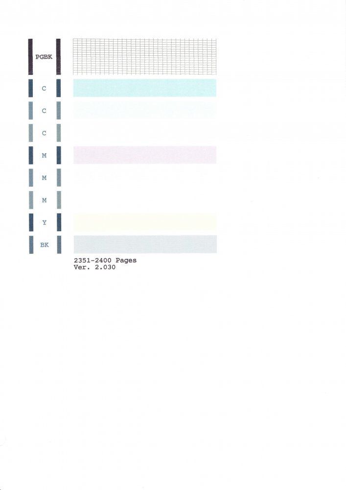

I think there is a problem with the pigment black nozzles. Could you upload a standard nozzle check, if that is possible from your Linux install?

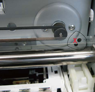

The first thing I would try would be to clean the timing strip on your printer, you’ll find this little plastic strip running from left to right just behind the print head, just rub it both sides with a cloth soaked in alcohol or Windex..

Looking at the full rez image of the PGBK matrix, it appears that your print head nozzles are worn or partially obstructed. There is evidence that PGBK ink is being mis-directed onto the paper. Also some lighter colors are not present in the nozzle check?
5,064
4,914
The zig-zag appearance of vertical lines in the first test print could be caused by a dirty timing strip as suggested by The Hat, so try cleaning the timing strip.
But there are also problems with the print head, looking at the high-resolution nozzle check I agree with turbguy, that the pigment black nozzles are partly clogged or worn, and regular cyan is too weak, and medium and light cyan are missing. Regular magenta is too weak and medium and light magenta are missing. Yellow is also too weak.
So a print head cleaning is also needed. I guess you have already tried nozzle cleaning from the maintenance tab in the printer driver? If not then try this cleaning first. There is no reason to use the intensive cleaning, as this stresses the print head much more than the regular cleaning. It is better to do two or mere regular cleanings with pauses between cleanings than using the intensive cleaning, as nozzles are fired during the cleaning process, and the nozzles need a flow of ink to cool them. For the same reason only nozzle checks should be printed until the print head problems are solved. No documents or worse, photos should be printed.
In case nozzle cleaning from the maintenance doesn't bring any improvement, cleaning of the print head outside the printer is necessary. Here is a gentle method I have used successfully. More radical methods for print head cleaning exist, but they have a higher risk of damaging the print head and likely also the logic board in the printer, making the printer a total loss.
When a Canon print head fails, there is a risk it also damages the logic board in the printer. A damaged logic board can damage a new Canon print head, so replacing a defective Canon print head is a gamble.

I noted the picture of the underside of your print head on the other forum. It looks to me like one of the black cartridges leaked and in doing so probably flooded the purge unit. The purge unit is vital in keeping the print head in good working condition, so as suggested by The Hat and Grandad35 the purge unit should be tested. Also make sure no cartridges are leaking, as leaking cartridges can do a lot of damage.
