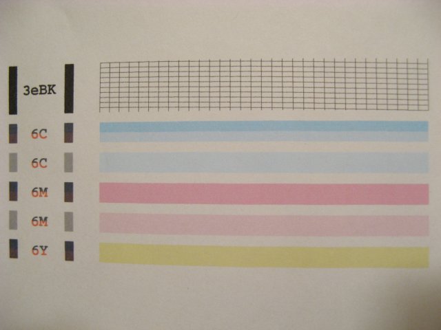

I see the smear problem. However, to my eyes it does not look to be a physical smear. To me it appears that some nozzles were not properly outputting.

it seems that almost immediately after the printhead prints the bird's tail, all of a sudden, in a straight line with the movement of the printhead, I am getting aberrant dots of Magenta, which create a broad band of rust color. In the photo of the Ocelot below the hummingbird, the problem can be seen only in the dark shadows of the tree stump. Precisely from the last 1 and 7/8 inches from the end of the 8.5 X 11 page, dark portions of the image are aberrantly sprayed with magenta. Now the question is why?
For some time there has been an oddity about my nozzle check pattern. Although there is no white streaking indicating clogged nozzles, the pattern is not quite the same as the Canon software says it should be. Rather that having one of the two bands of Cyan be dark, and the other band light, instead
the dark band is split down the middle. The lower half of it being light, and the upper half dark. ... then there is also the light Cyan band which is normal. Furthermore, the lower have of the letters 6C 6M 6Y are red instead of black, and the lower half of the greys are not true, but rather reddish ... Hmmm.
Here's my nozzle check pattern:
Somethings not right here, but why the printing seems fine until all of a sudden the last 1 and 7/8 inches is really mysterious.

When I looked at your output I actually thought Cyan was the issue. Make sure your cartridges are properly feeding and I'd flush out the printhead and then see what happens. I'm leaning that you need to prepare yourself for a new printhead not far down the road.
My further thoughts are that it isn't that the magenta is not supposed to be there but the other colors that ARE supposed to be there. I can't confirm this due to the lack of resolution of your scans however.

Does the nozzle check print look the way it's supposed to look? I thought the upper Cyan band was supposed to be solid darker blue. Not split down the middle, with the lower half being lighter blue. Also the bottom half of the letters 6C 6M 6Y are red! That's not right is it?

yuyakay, the letters on the left are made by mixing cmy together to make "black" hence why your not seeing black, rather just yellow and magenta mixed = red.
I believe the ip3000 printhead has 6 rows of nozels, two for each colour that are offset with each other, hence enabling bi-pass printing without getting stripes. Anyway, I would say that half of them on your Cyan have packed up.
Interestingly I get a very feint band where yours start but only occasionally, and thats been the same with 3 print heads under warranty.

This link discusses the situation where 1/2 of a nozzle check is light or missing. LOTS of reading to understand your nozzle check pattern, some possible solutions.

Really interesting post. Yes I'm convinced some of the Cyan ports are plugged. My Cyan Cartridge just started giving a low on ink message. Tomorrow I'll buy another one. I'm thinking of trying to blow out the port with compressed air as recommended on Neil's InkJet Page. From what I can gather it seems he thinks this is a better cleaning than the regular nozzle cleaning which uses ink and leads to the "Waste Ink Tank almost full" problem.
Anyone, is there any downside to using compressed air to blow out the nozzles? :/
