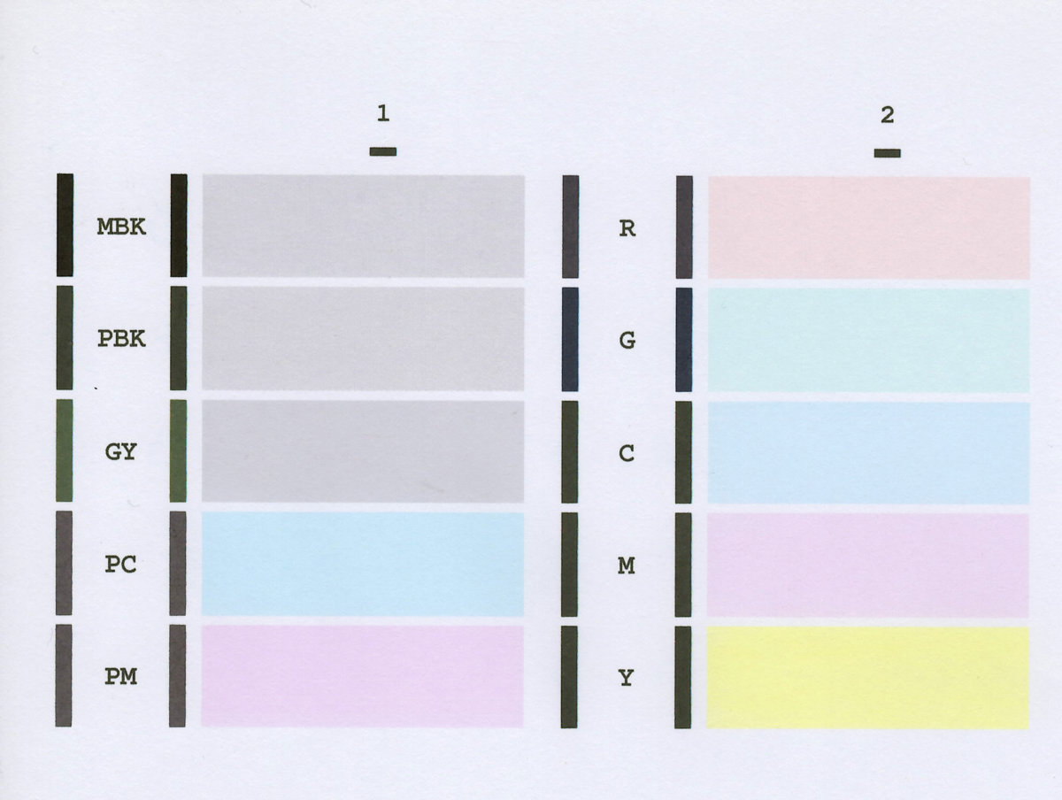

Well... I did it. I got the 9500 Mark II. It came with a full set in the printer (well almost full) and an extra full set of OEM carts along with a few stray full carts. It was a nice exchange, they kept all the "extras" like the setup cd and manual so this really helped getting it up and running. However, they wanted to meet at a local place (bought this off craigslist) so I couldn't test it out. They said that they haven't used it in awhile, so when I got it home, I immediately soaked the print head to clean it up.

Having an issue with getting a good nozzle check. Notice on the "C" channel that it looks like the top 20% is missing. I ran 2 cleaning cycles and 1 deep cleaning cycle so far.

I ran an ink quality maintenance followed by a nozzle check and things are looking much better today. :)
What is with the "GY" 2 bars? It looks to have a green tint?
Not too bad !
These green lines is a lateral displacement.
Could signal electrical disfunction.
