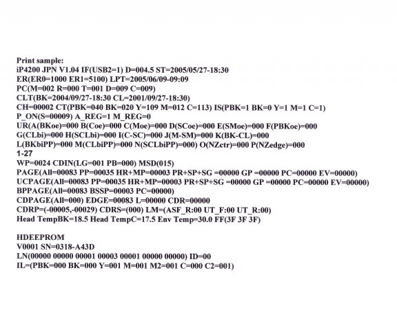

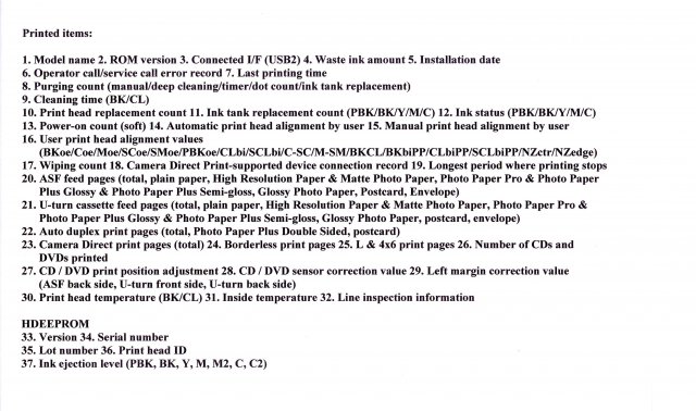

Smile,.. Gee,.. if there are no electronic functions that could be damaged by shorting out the pins, what were you hoping to accomplish by doing it???? You are free to do what every you want with your printer, just don't recommmend it to others. Ever since the first iP4200 printer was introduced with CLI-8 ink carts the Canon software has been capturing data about everything the printer does. Listed below is an Explanation of all the data they capture directly out of the Service Manual;
The image below is also from the service manual and is and example of what that data looks like when it is printed. As you can see they compress the information so if you don't have a service manual, you wouldn't know what your looking at. In the information print, item 11 is the Ink tank replacement count. You will also notice that there is HDEEprom data and explanation for that. It is basically everything about the carriage, printhead, and the current ink levels for each ink cart.
Just because we can reset the EEprom data on the main logic card, this does not affect the data on the Head EEprom or what ever eeprom there is on each cartridge chip. There continues to be more people reporting different types of ink carts reset problems, expecially those that have a late model iP4200 refurbished.
I am limited in any further testing I can do since all of the iP4200's I have still have solid RED ink carts and I have no plans to mess with these ink carts or test them in any way. If I had a damaged iP4200 I would do it ASAP, but these are all in great condition. I also don't have any empty CLI-8 ink carts except the ones in my iP6600d, which I use every day. I don't want to experiment with them either. I've never had my hands on a iP4300 or iP4500. If I get anymore info I will post it hear. There have been other posts that have suggested that resetting the EEprom data would restore the ink level but I don't think this will work as there are two records kept of the ink levels. If they don't match, I have no idea what will happen.
