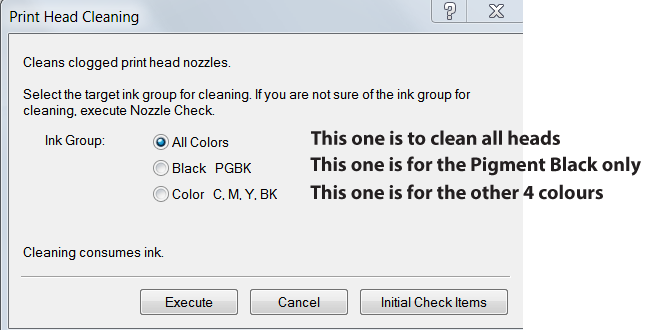

Follow @turbguy lead and replace the photo black cartridge with a new one (not refilled) and run a normal head clean on just the black side of the head and then print another nozzle check.

HAT--- How do I “run a normal head clean on just the black side of the head” and then print another nozzle check.?
