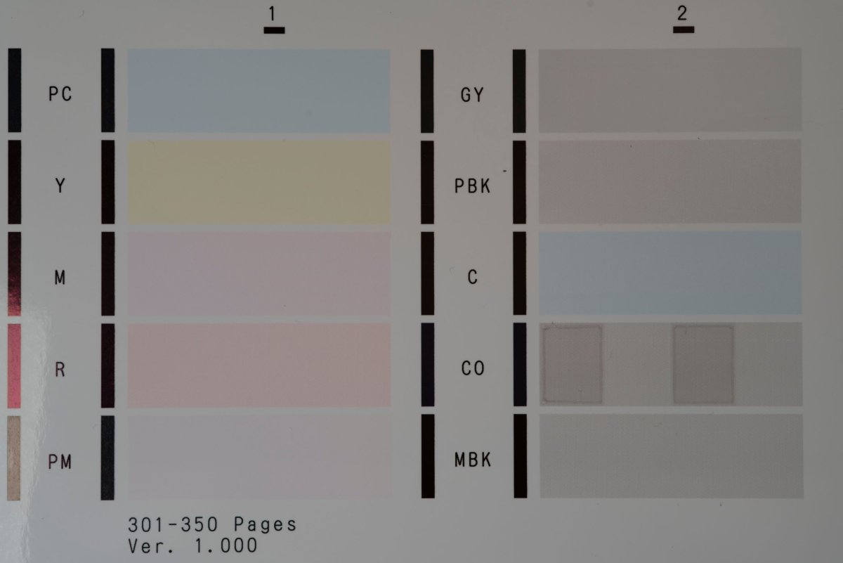

@The Hat @websnail The results are in...
I used a bottle of the OctoInkjet Cannon print head cleaning fluid to clean the print head using the 'passive' methods (no syringes, just pressure from the cleaning fluid saturated paper) outlined in this excellent video from OctoInkJet:
I then washed the head with tap water, then flushed it all out with distilled water, rinsed the PCB with 99% Isopropyl alcohol just to be sure and then left hte head to dry overnight.
I installed a brand new set of Octoinkjet PGI-72 inks and printed a nozzle check - it was MUCH better than my attempts before cleaning, every colour was showing as it should but it had a few missing lines so I did one clean cycle.
Then I printed out two more nozzle checks on the same piece of Canon Photo Plus Glossy II paper so I could really get an idea of the ink flow - it looked perfect from the start but there seem to be a couple of issues.
1) The CO rectangle seems to have some odd border around it - almost like a watermark, even though it has been left to dry.
2) The Red and Grey rectangles have extremely faint dotted lines in them - its not like the lines I saw when the printhead was really clogged, but rather a sequence of blank spots along a line. There look to be a couple on each rectangle and they are very faint - I've attached some macro shots here so you can see them.
Otherwise everything else seems to be fine! I have only done one cleaning cycle since refitting the cleaned head - should I wait a day before attmepting another or would a deep clean be better? Many thanks!

No, with what you have now, your good to go, it’s been an experience for you, but in the end well worth it, just go and enjoy the prints you’ve been waiting to print..

I was secretly hoping you'd day that 😄! Its definitely been a learning experience - but to have a working Pro-10s with full quality inks for under £70 is very lucky! Thank you very much for all of your help - its been really appreciated!

Definitively you need to improve further. This nozzle test isn’t as good as it should be. See the vertical bars at the left of some colors, specially red but also magenta and photomagenta. Those should be black, not reddish or faint grey.
If you use third party inks or a combination of OEM and third party probably some bars won't be neutral because of ink mismatching, See for instance a scan of my Pro10s nozzle test. As I use a mix of OEM and Octoinks, there’re bars not neutral black but slightly bluish or purple, In your nozzle check instead, the left bars beside red, photomagenta and bottom of the magenta are clearly off, a sign that something is not OK yet.

Any other little issues will soon be ironed out once a few prints are done and proper ink starts flowing once again.. Remember the original users ink was all crap..
