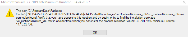

Here's the latest one I've just done. I'm very new to printing etc so most of what I'm doing is trial and error!
Also, as I'm trying to eliminate any other issues that could be causing this - could this error on my PC be something to do with it? Unsure if it's linked in the slightest
Let me know if there's anything else you'd like me to post to try and work out the issue!
