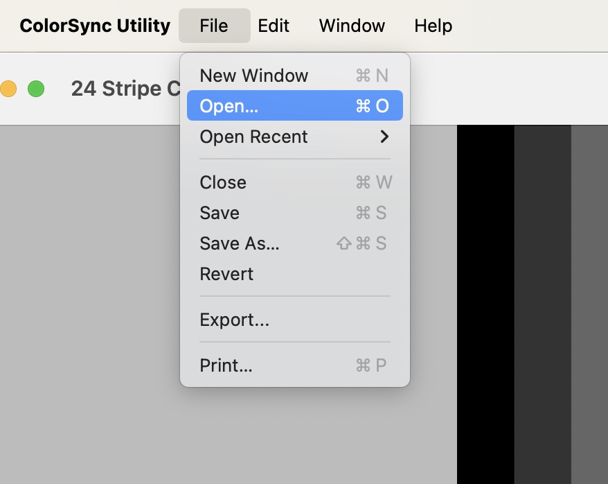

I believe you use a Mac so yo have another option using ColorSync Utility build into the Mac software.
First you open your file:

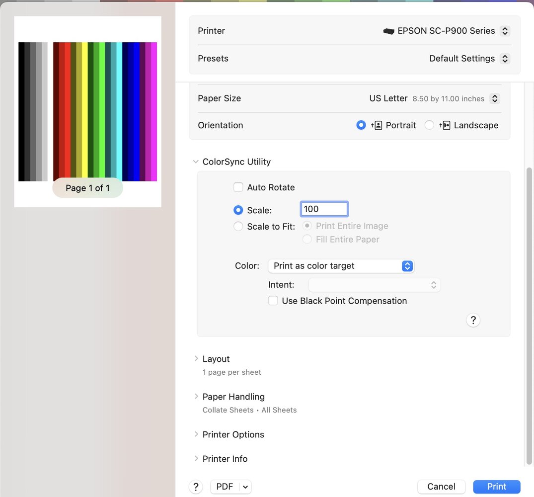

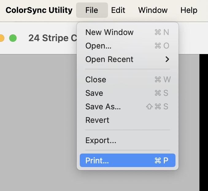

Then you go to print
Now things may be different at some point yet this is what I get. You want to set the print mode to Print Target.
I also set the sacle to 100% though that should not matter

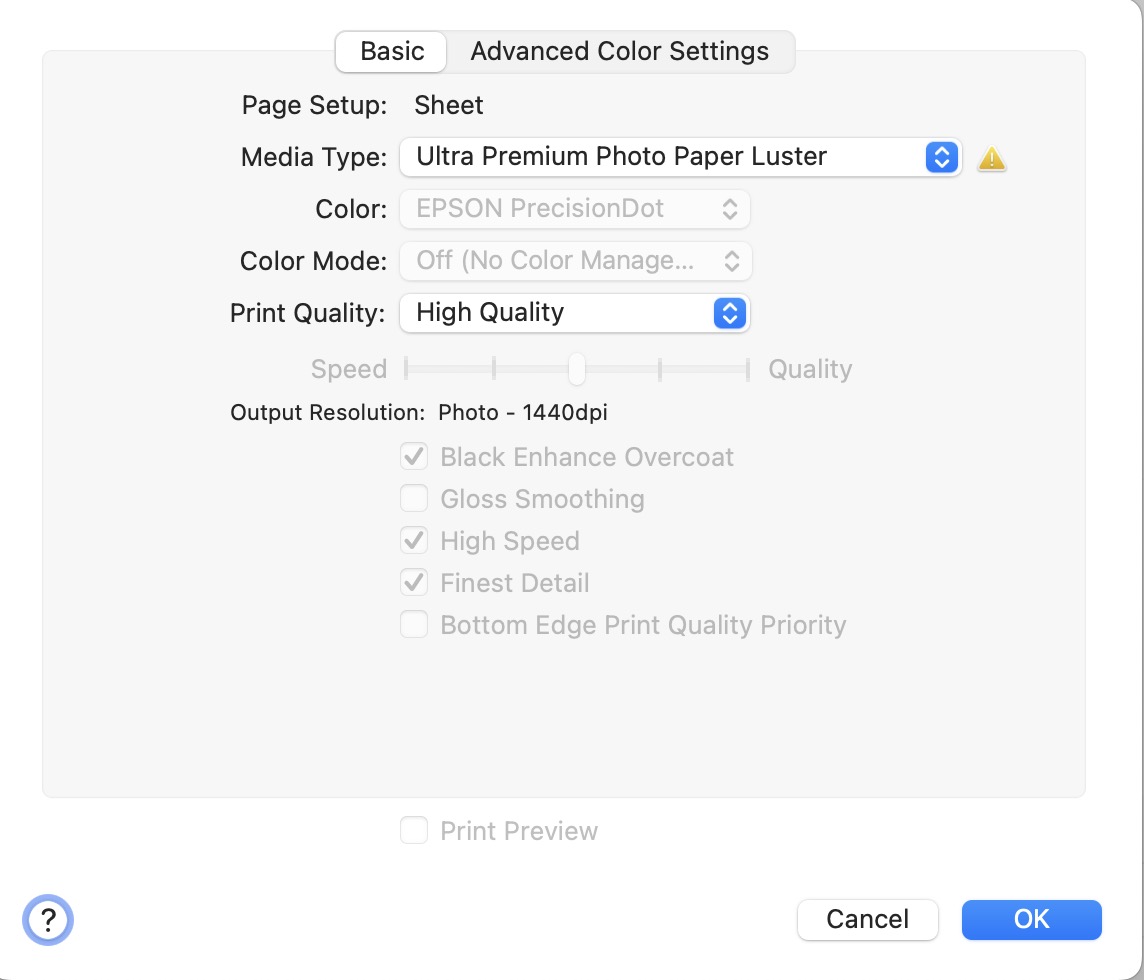

Now this part is specific to the printer driver yet here is what it looks like for the Epson p900.
You want to select the paper options and quality level as you would under normal printing conditions.
For me that was Epson Ultra Premium Luster
And for print quality I used High Quality
Note that it tells you color maangement is off because you already selected to use the "Print Target" mode.
Hope that helps
