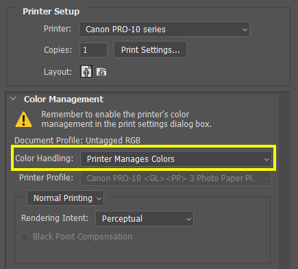

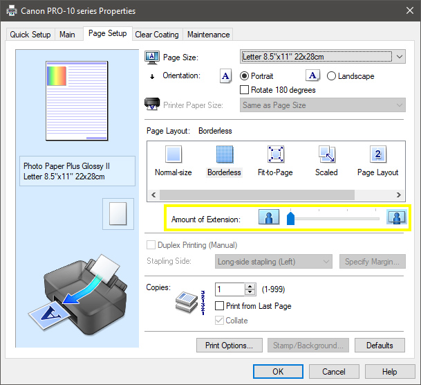

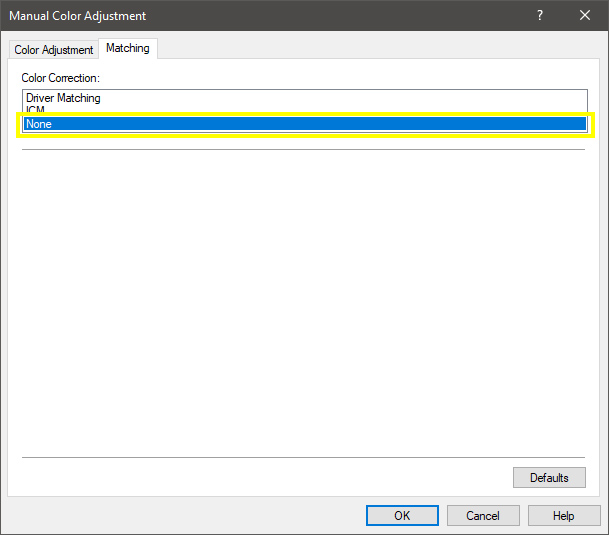

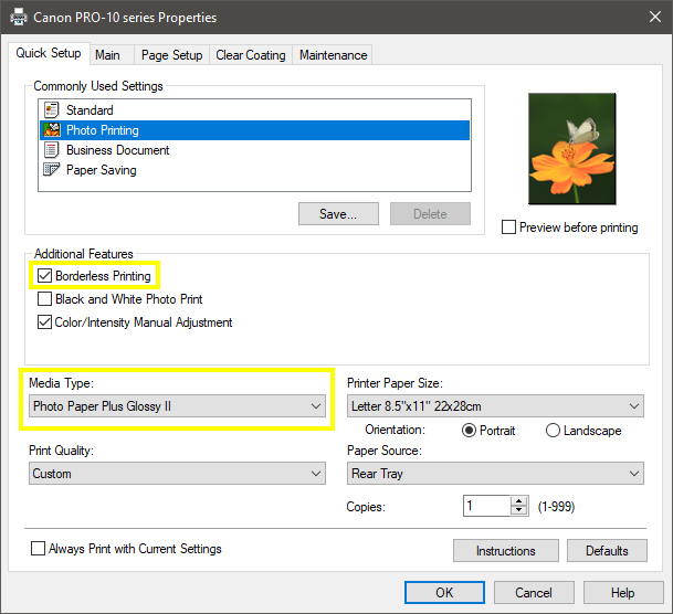

When printing these targets in Photoshop with a Canon Pro-10, are these the correct settings? Just want to make sure I'm not missing anything.
Photoshop Print Settings:
1) Color Handling: Printer Manages Color
Printer Settings:
2) Quick Setup > Media Type: (select correct paper profile)
3) Quick Setup > Additional Features: Borderless Printing
4) Main > Color/Intensity > Manual: Set... > Matching > Color Correction: None
5) Page Setup: Amount of Extension: 0 (slider all the way to the left)
Also, I'm assuming I should have Adobe RGB (1998) selected for the colorspace?
I went ahead and did a print, but the colors seem really off to me, the greens come out aqua, and the cyan comes out cerulean blue. They actually appear better when printed in sRGB.
Just want to make sure I have the right print settings.

No the settings are incorrect and will not produce the required results. The targets need to be printed without colour management of any kind. In Photoshop it has not been possible to turn off colour management since and age ago.
You will need to use the Adobe Color Print Utility (ACPU) to effectively print your targets without colour management
https://helpx.adobe.com/photoshop/kb/no-color-management-option-missing.html
Alternatively you could try the ArgyllCMS printtarg command:
https://www.argyllcms.com/doc/printtarg.html
A long time since I used it but Little ArgyllGUI puts a slightly more friendly user interface to the procedure
https://www.russellcottrell.com/photo/LittleArgyllGUI.php?redirected_from=/photo/LittleArgyllGUI.asp
