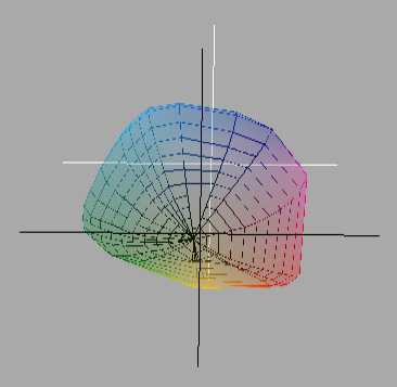

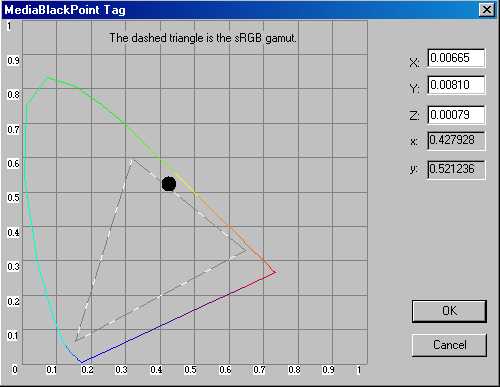

The black point position of your 3880 profile (image 1) is very different from that of a CM 9000 ll profile (image 2). Looks very strange!

Thanks emulator, so the bug in the 1.60 version is real. I will reread the patches using version 1.40 of ArgyllCMS.

Using the Wincolor display of the whole 3880 profile, it is not just the black point shift that may be the problem. If you look at the two axes at each end of the mesh display, the whole mesh centre line appears to be slightly shifted and slanted when compared to other profiles.

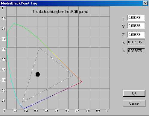

I did receive some feedback from emulator and the results with version 1.40 are now similar to the normal profiles concerning the black point, so the black point measurement deviance with version 1.60 is real. So please roll-back to version 1.40 to solve this problem.

I have checked all of your 6 ArgyllCMS 1.40 profiles and they all have normal black point positions. They also have structures aligning with the black and white centre axes, (unlike post#25). So I think you can safely blame 1.60!
