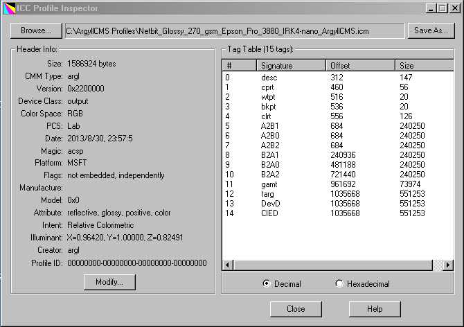

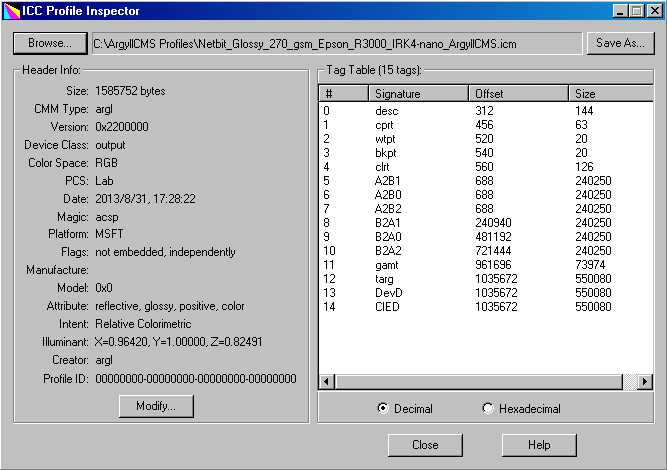

Hi pharmacist,
Thanks for the three profiles. These are the three ICC Profile Inspector opening pages:-
Click to enlarge
Now all we have to do is work out the meaning of the differences.
Regards Emu
P.S. It pays to print out each image on a piece of A4

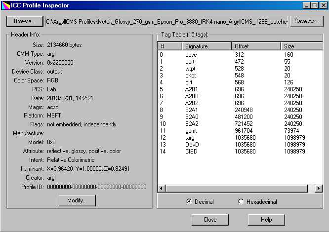

Hi Emulator,
I suggest you to upload both files to the website iccview.de (german/english) and have a look particularly of the Netbit Glossy profile for the Epson Pro 3880 (both the 648 patch standard and the 1296 high patch count profile) and have a look at the 3D image of both profiles. The difference between 648 and 1296 patch profiles is less than 1 %. Also softproofing using both profiles can give you an idea about the hardly to see difference of both profiles.
Note: the last profile is for the R3000 !!!
2,736
1,538
SC-900 ET-8550 WF-7840 TS705
I have experimented on creating profile making using the 648 patch Argyll CMS work flow and discovered Argyll CMS is able to squeeze out more available colours that can be reproduced by my printers. Gamut increase is about 15-25 %, not only by comparing the profiles with iccview.de but also in real world tests printing the same pictures with profiles created with the Colormunki software as well as the ones made with ArgyllCMS. I am not sure what is causing this difference, but the difference is nor printer or paper dependable. Especially out-of-gamut colours are reproduced more perceptually accurate towards the original colours on my screen, making the prints jumps out from the paper vividly.

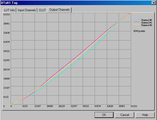

I have been spending a little time trying to get to grips with the profile data and the means to display their content, but it all takes up a lot of space, when trying to display the results.
(click to enlarge)
This, for example, is the set of colorimetric intent output curves for pharmacist's Epson Pro 3880 profile, the inputs being linear.:caf
