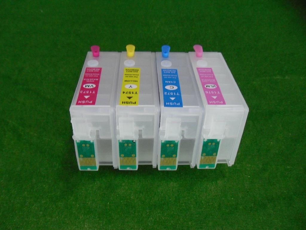

mild solvent or solvent based liquids would just melt away your printhead manifold AND ruin the printhead if left unmaintained
last and cheapest solution for FULL A3 gloss printing was the workforce WF7015 (wf7010 in usa)
it a nozzle beast: Black 384, each other color: 128
and sold for like 130€ inkl. 40€ wort of ink
either via "BLACK" only Printing and fitting a R3000 refillable cart with the T1301 Chip
or with help of QuadTonerip
the WF7015 is a fast beast in full page printing
