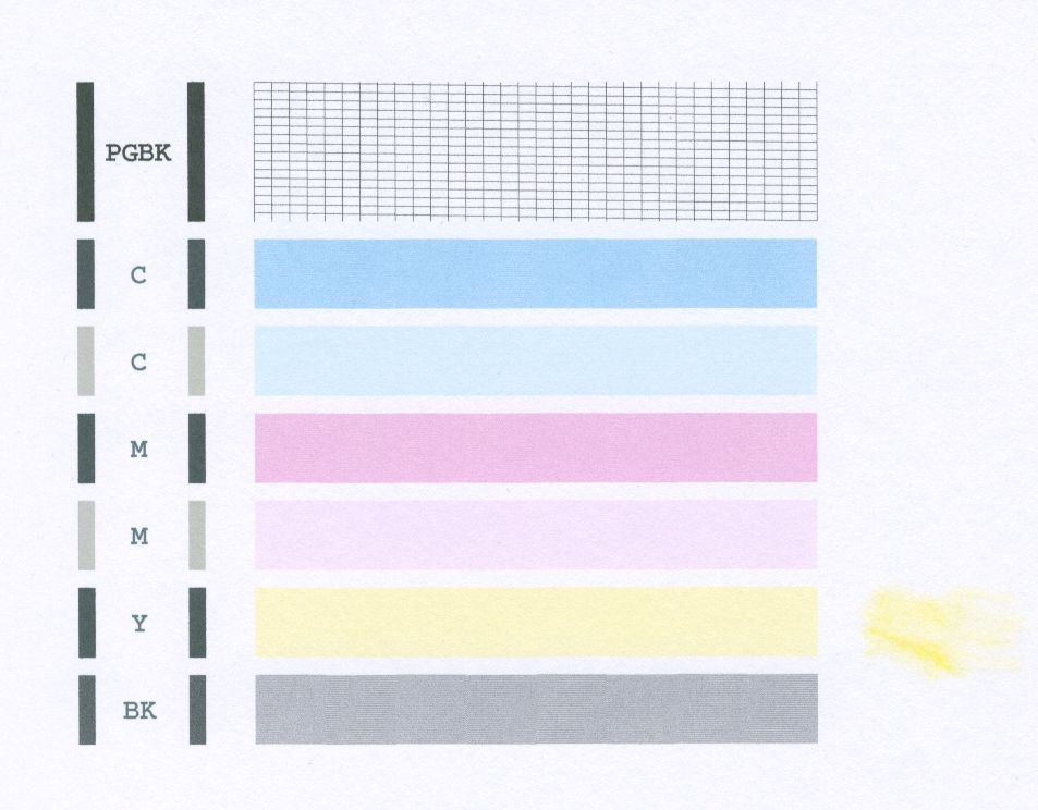

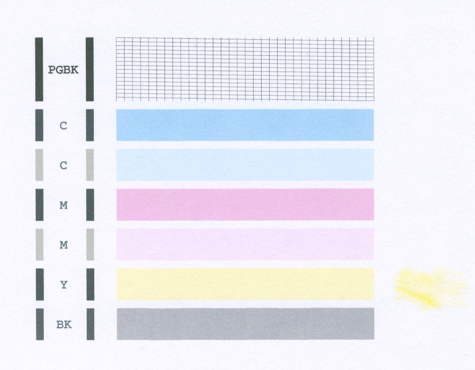

Here is a nozzle check from a Canon MP800. After printing it I touched a Q-tip to the ink outlet of the yellow cartridge. After having wiped off most of the ink in the Q-tip I made a marking close to the yellow stripe in the nozzle check. Notice that the colour match is very good. Click to enlarge:
I don't know much about Epson printers but when Canon printheads get old an internal leak can cause cross contamination. Often the yellow is contaminated with black. Cross contamination can also happen when the print head is parked on the purge unit/parking station. If a cartridge is leaking the ink will pool under the nozzle plate and leaked ink might be wicked up in nozzle sets for other colours and cause cross contamination.
If nothing went wrong when filling the printer with ink, then I think something must be wrong with the printer or the yellow ink. Could you make a nozzle check and compare the yellow print to the yellow ink in the tank and the yellow ink in the bottle?
Even if the printer is not a photo printer but intended for office use I think the colour error is not acceptable.

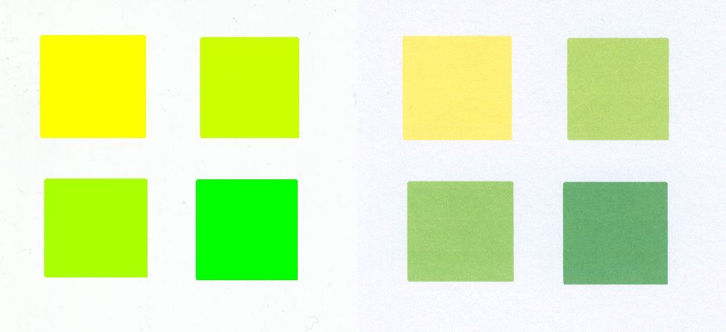

Using Irfan View I made a test image like yours with the same RGB values of colour. I printed and scanned it for comparison using a Canon MP800 with OEM ink on plain paper with default settings. The result is not perfect, there is a little reddish or magenta cast to the print which is typical of many Canon printers.
I also think the problem might be caused in translation of colours from RGB values used by the monitor to CMY(K) values used by the printer.
Here is the image. The screen picture is to the left, the scanned print is to the right. The scan is not perfect but close to what the print looks like. But comparing screen and printed images is difficult:
It's not just difficult, it is often a fool's errand with low end printers, uncalibrated monitors, non-standardized ambient lighting, and paper not matched by the ICC printer profile. Holding the print up against the monitor adds a layer of perceptual errata as well.

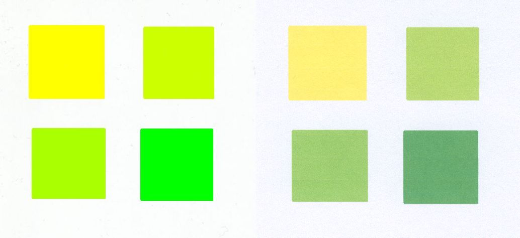

Thanks for taking the time to do this!
This looks very much like it does on my prints. I guess it speaks to the hypothesis that there is nothing "wrong" with my printer, this is just the way printers, especially low end, work. And of course, comparing monitor and paper makes little sense, as many others have mentioned.
And there is nothing that is plain "wrong" with the prints I get either. I have now printed many different kinds of images, on different paper, with different settings, and it is not that they look horrible (I take back some of the things I said in the beginning). In fact, many of the prints look great, especially "simpler" stuff, like artworks, vector based images and other things that are not photos. But also photos generally look "good", especially if you just see the printed image without anything to compare.
