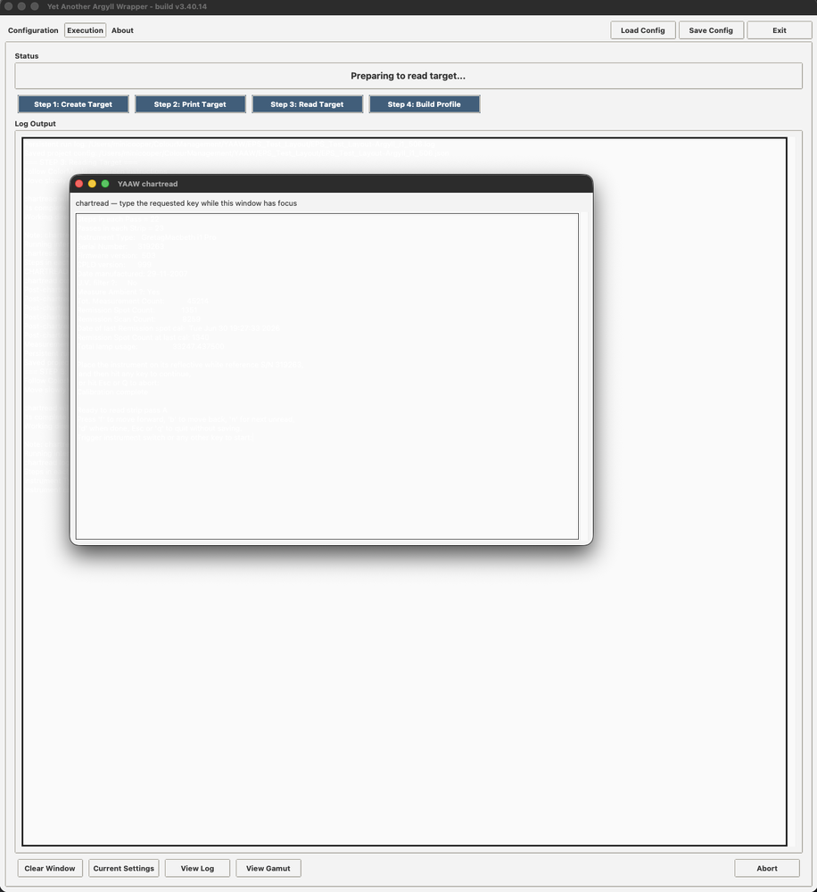

Don't forget also that by default, YAAW does not suppress chartread unexpected delta-E warnings so unusual readings will be exposed there - although admittedly this information does not appear in the logfile since chartread runs in its own terminal window.Well, I think both sides have valid arguments. For me it's merely out of interest how far my printed target is away from the expected values. Using an i1pro with the standard ruler/jig doesn't give much room for user created mis-measurement, but that might be completely different with other devices. Way off values might indicate reading errors, but also - perhaps - problems with the printer (i. e. nozzles not firing). Ultimately it's a personal preference, how one would like to interpret the values. As you already stated: No big effort to run a shell script afterwards and also append the data to the existent log file.
