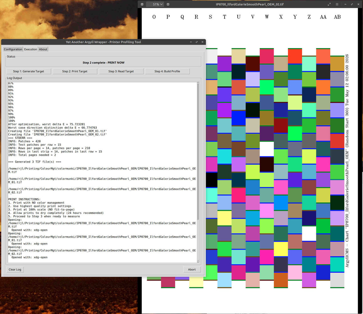

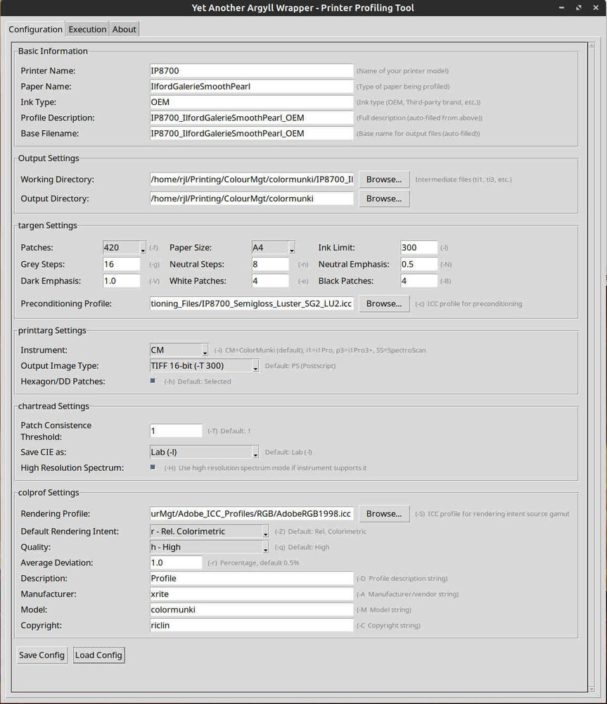

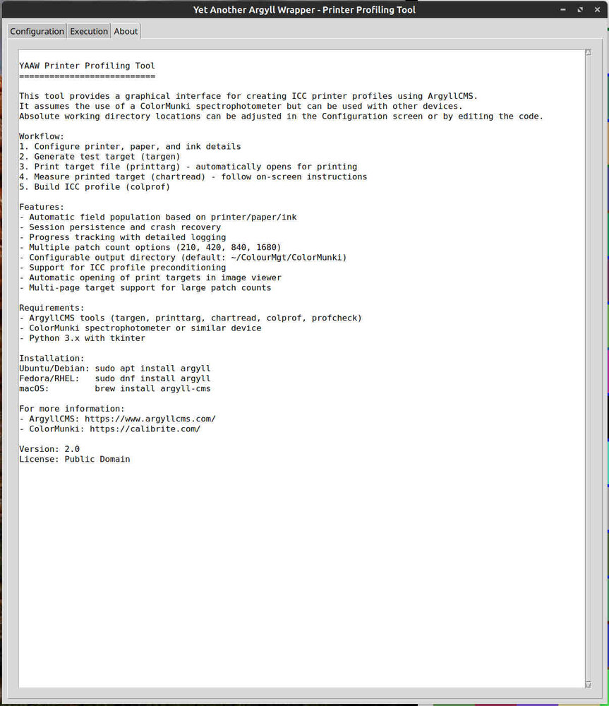

At the expense of jumping on the bandwagon, Claude and I have written yet another wrapper to simplify the process of preparing printer profiles with Argyll CMS. There are several of these around but none really suited my requirements. Anyway - take a look and see whether this may be of use. It's written in Python so should be fairly portable and is available for your viewing pleasure at:
https://drive.google.com/file/d/1kGeeNQ0dPzOaBl6ALWpYmKdM-XUIdDNZ/view?usp=drive_link
Feel free to hack/modify/bin as you see fit.
