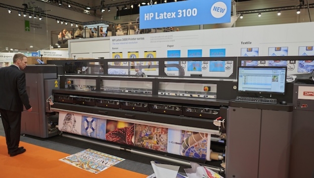

Ultimately the p800 is not wide enough to do decent sized canvas wraps,
I guess such a printer would offer a suitable width then...
The WF 3620 and the WF 7110 appear to have the same printhread, so printing speed will be about the same. Do you need the width of the WF-7110 for your printing jobs ? Or is the paper feeding an issue ?
Yeah, but my wife would use me as the media for a test print...
I was looking at the flexibility of the width with the 7110.
