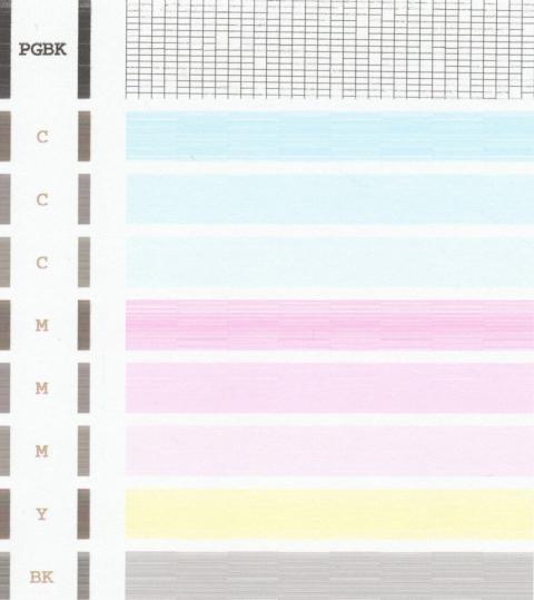

I used ionized water, 20% isopropyl alcohol and a few drops of ammonia as soaking solution. The print head was laid with the head down onto soaked tissue paper with enough solution to cover the inlets.
Haven't tried the vinegar solution yet, leaving that as a last resort as I'll need to buy some first.
The checkered patterns are caused by the printer.
I've done the usual nozzle clean including the deep clean, and changed the ink cartridges without success.
7,177
No change in your nozzle check or the other patterns in that second image AFTER several days of soaking means you were using the wrong solution, not enough solution, there is no clog, or the print head or logic assay board are malfunctioning independent of any clog that may or may not be.
I don't recall printing a page like you have in the second image, but if that checkered appearance is not normal then you either have a electrical malfunction in the print head or the logic assay board.
Have you had any error messages from the printer?

I've got the distilled vinegar today and first soaked it for 0.5 hrs but still had nozzle problem so gave the head another soak this time for 1hr. Bad news is although I got the darkest cyan working but the lighter shades of cyan and magenta still have streaks :hit Good news is my print head smells like fish and chips :D
Is there any more I can do or is there no more can be done. If not, I'm afraid my printer is no longer fit to produce photo prints except just general non critical work. Maybe is time to buy a new printer.

I've been going through an alternating cycle of vinegar soak and Pharmacist's mix and was getting better results until I got a clog which caused gradual starvation of the the magenta ink. No matter how many times I tried to clean the magenta nozzle it would just got worse until no magenta was coming out.
I thought about dismantling the print head for a while and finally bit the bullet and did it. Good news the clog was in within the black block of the head so I applied the full force of a syringe to push/pull on the magenta channel. The clog finally dislodged and re-assembled the head after cleaning the rubber gasket and copper coloured head. During re-assembly, I aligned the holes of the gasket with the holes of the black block and pressed down so that it sealed in tight so even when held upside down it would not fall down. Then I carefully placed the head on top and screwed the 2 screw tight.
Here the picture of what I get now :hit
Done numerous cleaning cycle on the printer and reassembled the print head a few times without success.
Can anything be done now to salvage this or has the print head been damaged permanently.
