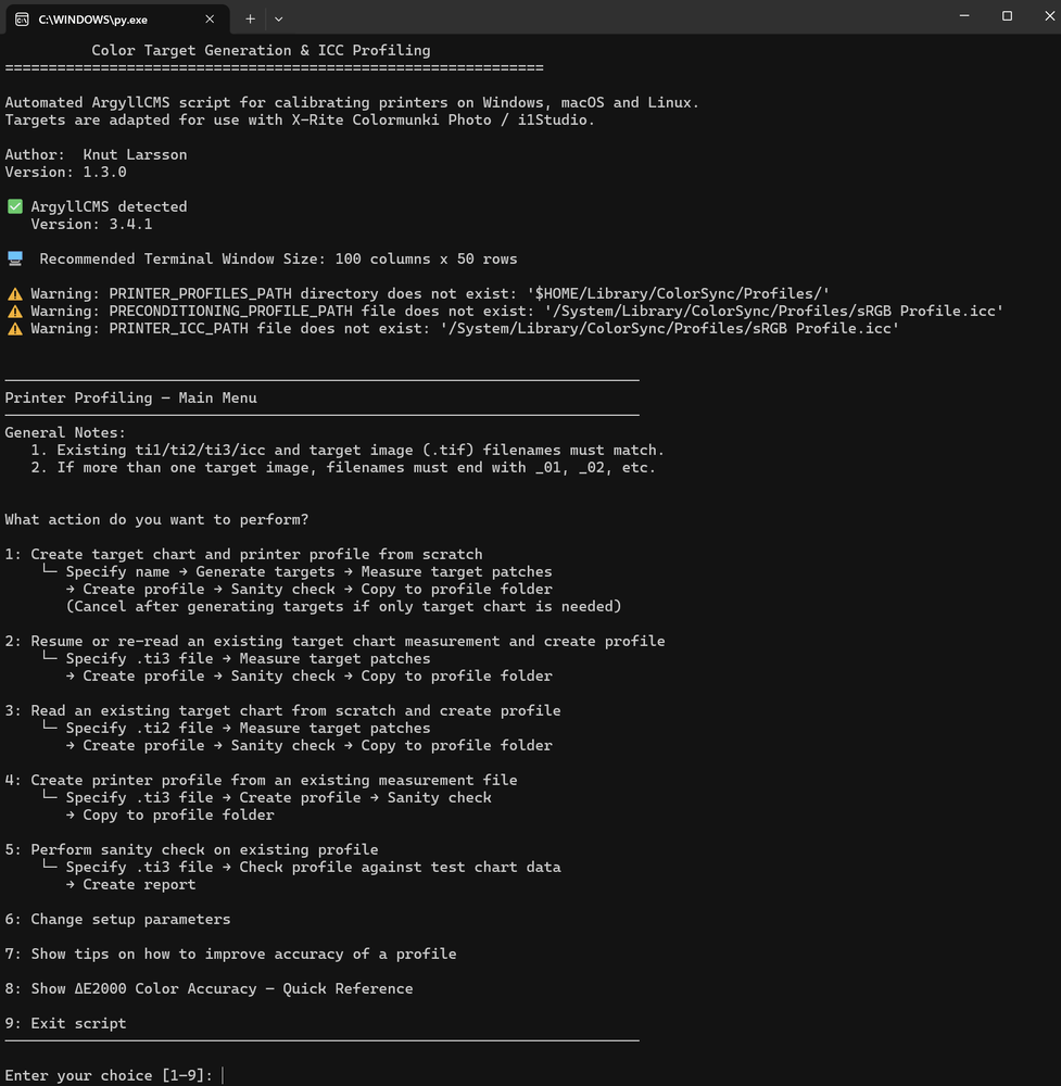

I tried to have a look at the program, but I think some settings are based on the directory structure of MacOS (Unix):
See the yellow warning exclamation symbols on the top.
Yes, in the script User Guide, section Getting Started I mention to change some parameters according to your need and platform. Since you are using windows, you will get these messages until you change the paths to some that actually exist. So the script checks for you if selected folder paths are valid.
The most important parameters, especially those with paths, can be interactively changed in menu option 6 using a selection pop-up window, so that one does not have to write long paths by hand.
Otherwise, the .ini file has examples on paths for the various parameters, and the User Guide has also some examples, such as path for icc-profile-installation.
