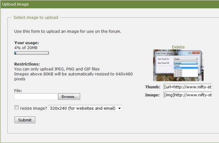

I uploaded the image yesterday. Are you able to see it? Thanks.

Go to "Uploads" section, copy the "thumb" link of your image and paste it in your post here.

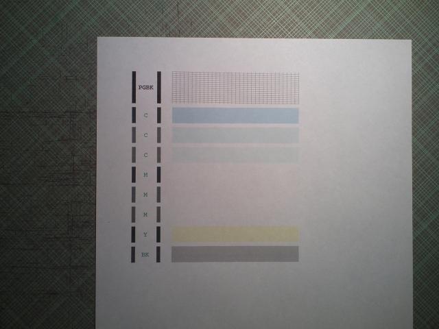

This should be better:

There is no "thumb"function when uploading a picture on niffty, unless you are reffering to resizing it to 160x120 (thumbnail) and that is not the case. His picture is 240x260.
Click on this:

Sorry if I'm not clear with the problem: I bought the Canon ip4820 a few months ago and use it at least 3 times a week refilling cartridges often. I use a small scale to weigh the black cartridges and avoid printing when empty. A week ago magenta began giving me problems - after software cleaning (repeated normal and then "deep") nozzle checks were either steaked or completely blank. All other colours are fine. I then removed and rinsed/bathed print head. Problem was fixed for a few prints then magenta blank again. I repeated head clean techniqe and also used steam from kettle (recomended by local ink supply store manager). Magenta was fine for 30+ colour prints and magenta problem again. I bought a new canon magenta cartridge in case the previous was faulty. Still more problems.
Weird thing is that it will print well for a series of the same image - I print about 30 sheets of 8.5" x 11" of the same image at a time. When I refill cartridges and try to print another image . . . the magenta then has problems - even if magenta has not been refilled. How can the ink flow well for many prints and then suddenly stop completely when I go to another image?
I'll see if Canon will send a new print head or printer (or I'll bite the bullet and buy a new one -recommendations?) but I am curious about this problem. Thanks.

All I can say is that I don't see Magenta. I can't tell if there are any other issues with the nozzle check. Since print head cleanings do correct the problem for a while, then it sounds like you have a clog. You've tried a new OEM Canon cartridge and that didn't completely resolve the problem - streaking or no ink reoccurred. If this is a correct summation of your issues then you can continue to try and unclog your print head using a technique I discussed in my above post to leoo. How long it will take is unknown. Which method works best is up for conjecture. I've tried tap water flushing, submerging the print head in various fluid potions, and using cartridges filled with cleaning solution and doing cleaning cycles. I have not yet tried the method that uses paper towels underneath the print head but it sounds as good as any other method.
