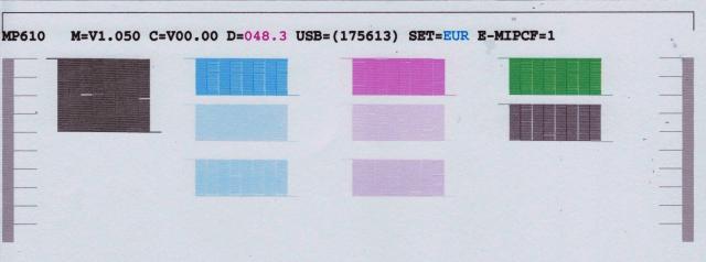

Inkoholic,...I finally got a look at your Service Test print. The truth is it is not that bad. The black section only 2 nozzles missing, and I'm sure those should come clean with normal clean process. The Cyan head shows unbalanced printing in both directions which shows that while ALL nozzles are working, some are weaker than others. It is also a little out of head alignment,..but there are NO burnt out nozzles or totally missing nozzles in the Cyan. There are only 3 nozzles missing in the Magenta. There are 4 missing nozzles in the Photo Cyan and 2 missing in the Photo Magenta. The Photo black is missing 3. None of this is serious if you are printing everyday paper. If you want to print photographs, then use some manual setting and put the quality number to 4 or 5. This will insure your photos come out ok. If you are looking to a TOP QUALITY PHOTO out of this printer, then you need to spend more time getting it clean. The cleaning ink cart won't do you much good unless you install one of each color,..as you are correct and the Pixma series has eliminated the separate cleaning controls for color and black. The only way to use the clean ink carts is if you have one for each color. If you don't want to expend that much time, then your choice is to remove the head and clean it several times in the sink using hot water and focus the stream on the bottom nozzles, especially the colors that you know are missing nozzles. Then "Prime" the head by doing a "Deep Cleaning cycle in the machine with know good ink carts. Print the nozzle test and if that is not perfect then print the Service test print to see if anything improved. If it doesn't improve,..it is time to move on and buy a head. This is my last suggestion and response to your post which has gone on way too long,.. 14+ pages....UGH.
http://www.nifty-stuff.com/forum/uploads/1854_9hnsr50-enh.jpg
The cyan is unbalanced yes! But how do I rebalance it? I've tried auto head alignment but that never really did anything. I've tried manual alignment but I don't know how that works. Can't make heads or tails of it. But if I align the head, will the cyan then come out OK?
Pretty much all nozzles are working but the unbalanced cyan is making things ugly (I have high standards :p)

Install a new printhead. The nozzles are worn out.
