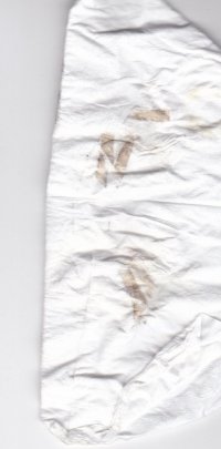

So I did Step 1, and I see perfect color printing, however my main issue of Black line patterns being wavy/weird is not gone :( Here are the results now...
One thing I should add is that the timing strip had a LOT OF dirt on it. Even after wiping it 4-5 times with alcohol, it was still leaving behind brown residue. Taking out the timing strip and seeing it under a light, I noticed a black dot in the middle of the timing strip(left side of the strip), and certain other whitish marks that don't go away upon scrubbing with alcohol. I gave up on trying to clean that and restored it back. It looks like they aren't having an impact on the operation of the printer, seeing how color printer is working properly...
Here's how much dirt came out, lol. Based on your recommendations, I can continue cleaning until all the residue is gone.
Yes, there are timing marks on the timing strip. If you damage the marks or the strip then your printer will n ever print properly unless you replace the timing strip. If something won't come off with gentle cleaning then it might be there for a reason.

I think the timing strip is now OK, I see no white vertical bands in the coloured nozzle check stripes. Even if there is a little banding in the rainbow coloured test stripe I think the colour cartridge is OK for plain paper documents. The colour balance is OK as the vertical bars besides the CCMMYY lettering in the nozzle test are neutral grey.
The black cartridge should be cleaned or replaced. In stead of opening the cartridge try cleaning the nozzles by pressing them alternately on a soft paper handkerchief wetted with a window cleaner with ammonia or pharmacist's cleaning solution and a dry paper handkerchief.
