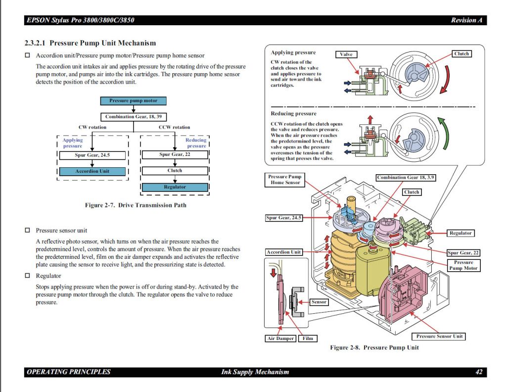

You guys need to be cautious. The 3800/3880 uses a pressurised cartridge system. The air inlet plug (yellow when on as you described) pumps air into the cartridge via a pump inside the printer and this is regulated by a valve inside the printer. There is one common pump. Please check the service manual for details.
On the original OEM carts the ink is held in a bladder. The pump system to the cartridge is always separated from the printer securely by this bladder bag....similar to the Canon Pro-1 and the larger wide format printers. On these refillable carts, the pressure and pump path is directly linked to the ink. There is NO physical barrier of a bladder wall. If for some reason the ink were to leak back into the pressure path, then it is possible to have the ink leak back into the printer pump or even cross contaminate to the other colors when the pump reinitiates.
I would not want ink leaking back into the printer where the original would never allow this. Could be big trouble if it happened.

I say be cautious because technically it looks not to be a good idea because of the design of the refillable. I think you're misunderstanding my explanation. The original OEM cartridge has a bag of ink inside a sealed chamber. No matter how hard you squeeze back on the bag, there is never any ink that will come back through the pressure inlet because the bag is inside a separate chamber into which the pressure is applied. This is like the Canon Pro-1. On these refillable carts there might/should exist a flapper valve inside which is simply a rubber disc over a hole to make sure that there is a check valve function. Sometimes these flapper valves don't seat well and ink seeps back out like your toilet tank flapper valve and ink can come out the pressure inlet just like how your toilet tank leaks. It's not the membrane leaking on the refillable or the plug, it is the design itself that has a level of risk if not managed.
Let me explain further in the OEM design, the air from the printer pump NEVER comes into DIRECT contact with the ink. It is separated by the bag. In the refillable cart you have, the air from the pump comes into direct contact with the ink. Therein lies the risk. You need to take steps that ink will not go back. I think out of printer refilling and replacing the yellow cap when refilling is one such step.
Your method can work but if Murphy is around your neighborhood it can get nasty. I take a view that if things can happen, one day it will.

In the refillable, the pressure does not squash an ink pack but pressurizes the ink directly. The ability to prevent reverse flow will depend on whether Epson provided a check valve and they did not because they allow the release of pressure during standby and power off. None is shown or mentioned. The fail safe aspect is in the ink pack bag, which if anyone has taken a cart apart is of high quality and not likely to leak. When you open the top plug, and refill, the now open to the atmosphere static pressure force of the ink could force ink in the air path ink into a reverse path back to the printer?? It is anyone's guess unless you experimented with all sorts of ways or take everything apart and look at the engineering. You can experiment and see. If you thoroughly investigate this aspect and it is OK then by all means proceed.
Remember I said to be cautious that does not mean it doesn't work....it could just do the homework first.
