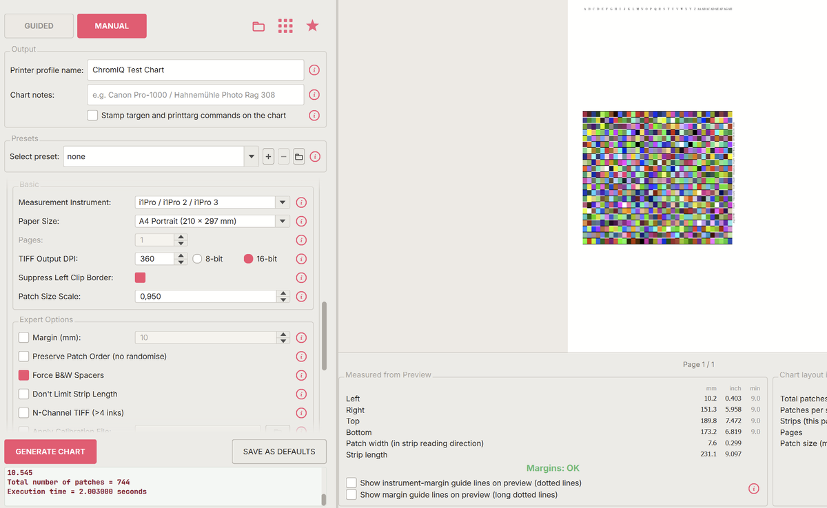

I don't see the margin settings for patch width/height either:
Just tried it on my Windows VM and you are right. Activating the engine in settings does not really activate it. I'll check
Edit: Update should be coming soon (beta 22 - not 21).
Edit 2: beta 22 should be online in a few minutes. Might need to turn it off and on again for it to work. the settings you make in the settings window auto save for the combination of instrument, paper and mode and you can recall them from the create chart tabs manual module.

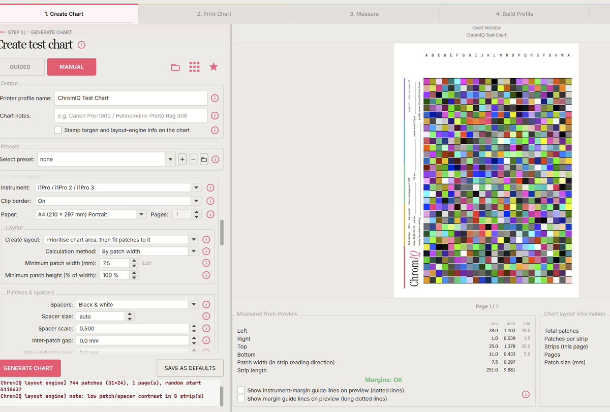

I just played a bit with the latest beta versions and I am impressed by the patch layout engine:
No photoshop needed to get a margin of 26 mm on the left and 38 mm from above, while keeping the patch layout of 24 rows of 31 patches with a minimum patch width of 7.5 mm: 744 patches on a single A4 sheet.

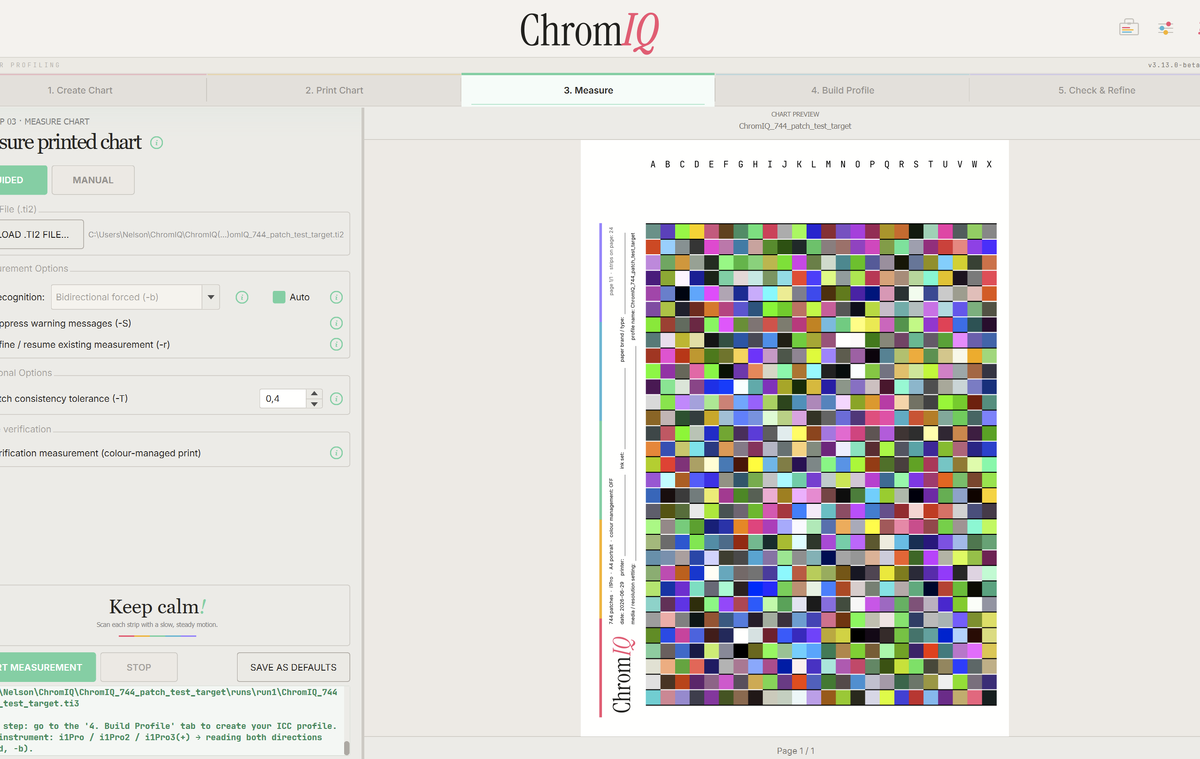

Nice that you like it. As always it needs some improvement. But one big point: I have not yet tried to measure such a chart to see whether the ti2 files for it are actually correctly created for this
@itsab1989 :I will print the target and test it and report back to see if the ti2 file is legit with the patch layout.
Ok here is my update:

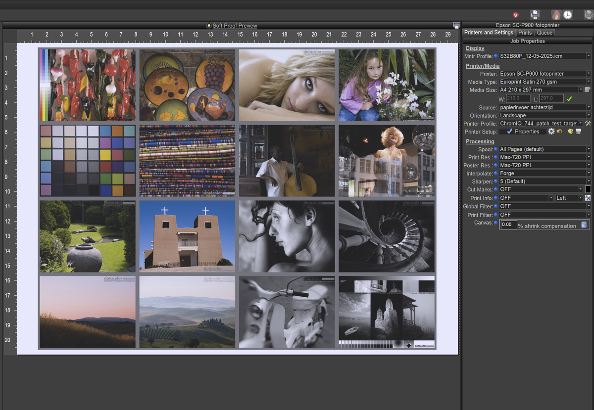

After creating the profile and softproofing:
The softproofing is perfect no strange banding whatsoever. Approved !!!
