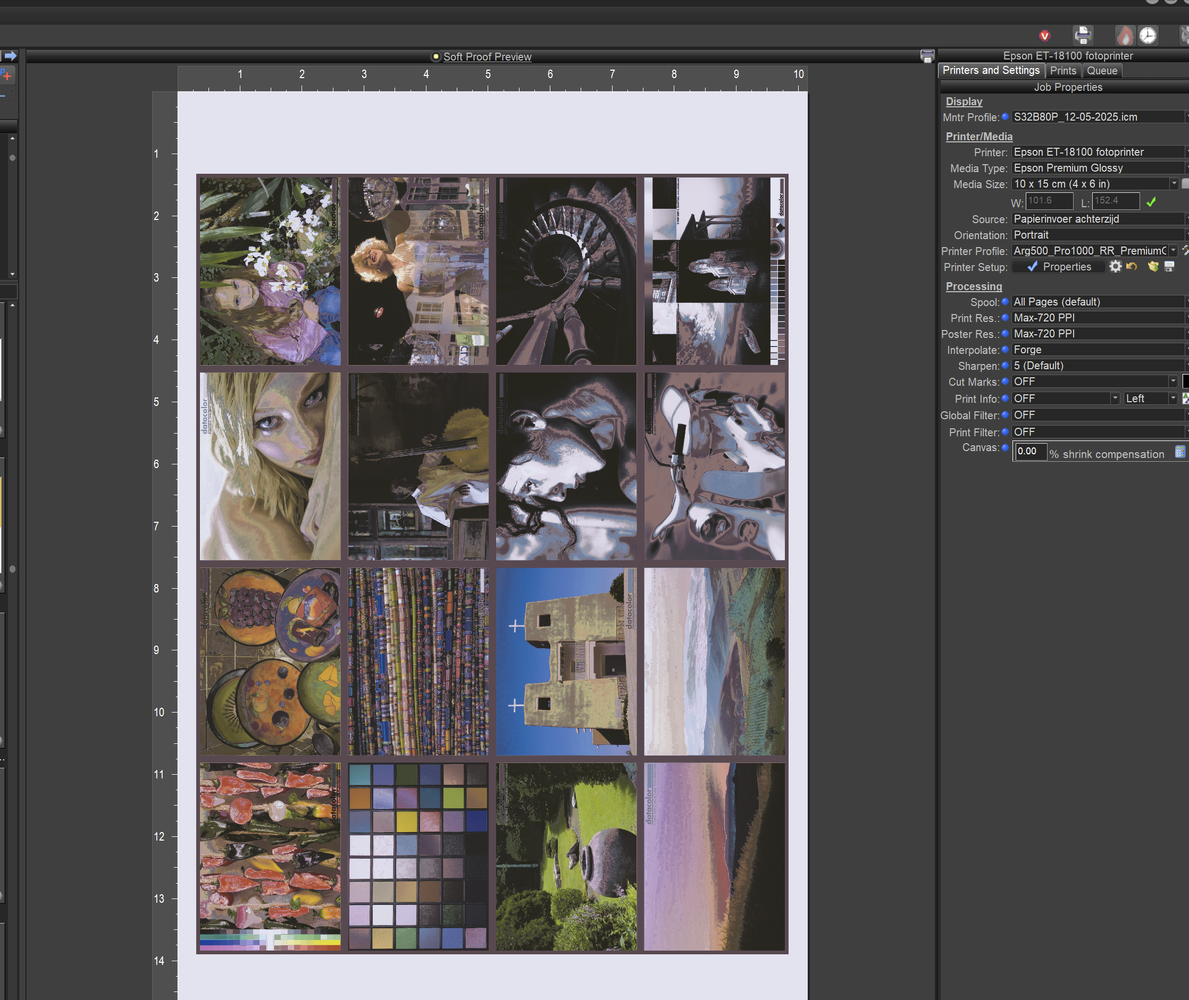

hi @pkk :
Best to have softproofing after creating the profile to see if the profile is correct or not, this is the softproofing of your faulty profile:
Are the patches randomized: if not choose the randomize button. I had terrible results with non-randomized patches, so my preset workflows are always randomized.
Your printers have multiple grey inks, so the TC9.24 preset target should already produce very neutral greys without a preconditioning profile to start with. Preconditioning will probably give only a small extra edge over the TC9.24, but most won't notice the extra improvement.
hi @pkk :
Do you think that could be an issue caused by wrong colormanagement when printing the target? I still have not heard from Canon regarding my problem with the printer driver and he is using a Canon printer as well. Though I do not know whether he is using macOS or Windows.
Actually I don't think about double profiling (known bug with MacOS and Airprint drivers that Apple tends to force upon you), because in this case you will only see a shift in hue, not the strang totally different colours you see in the above softproof. If I see the color strips the most likely problem are reading errors. Sometimes You can change the chartread argument -T into -T0.4 and enable error messages so you get a pop-up there are strip reading inconsistencies, because I believe this is disabled.

More info about the problematic 500 patch profile. I use Windows and it was not double profiled. I was given 6 boxes of it in greeting card size so I would like to be able to use it but It has been a problem child paper since I got it. The paper is Red River Premium Gloss which apparently has been discontinued so no RR profile is available. When I read the patches I had to read several rows 3 & 4 times to get it done. My plan, now that I have guidance from Pharmacist, is to move on to some other papers that I really need to get profiled. I’ll come back to this one when I get more experience with ChromIQ.

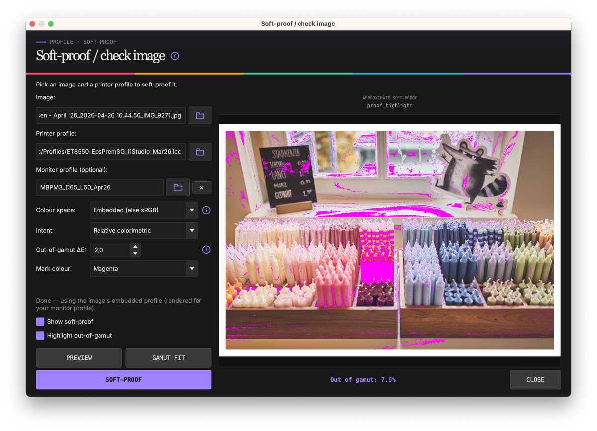

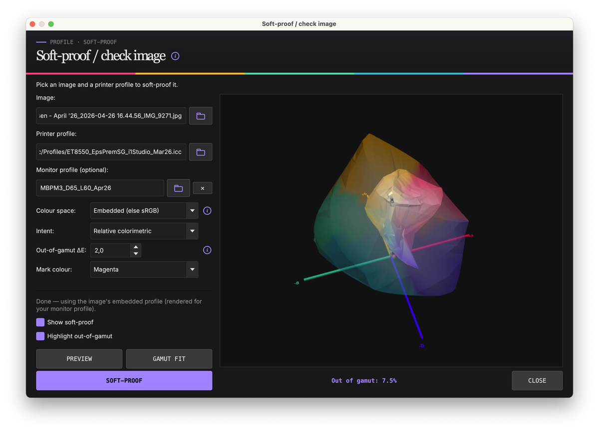

Just a quick info: in the latest version I added a new tool for some basic softproofing.
I like that. I'll be making a new profile tonight so I'll try it.
