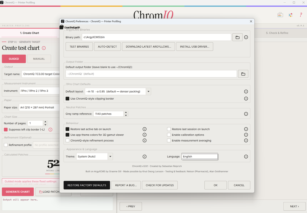

Not sure it is a bug or not, since I can only select english as language:

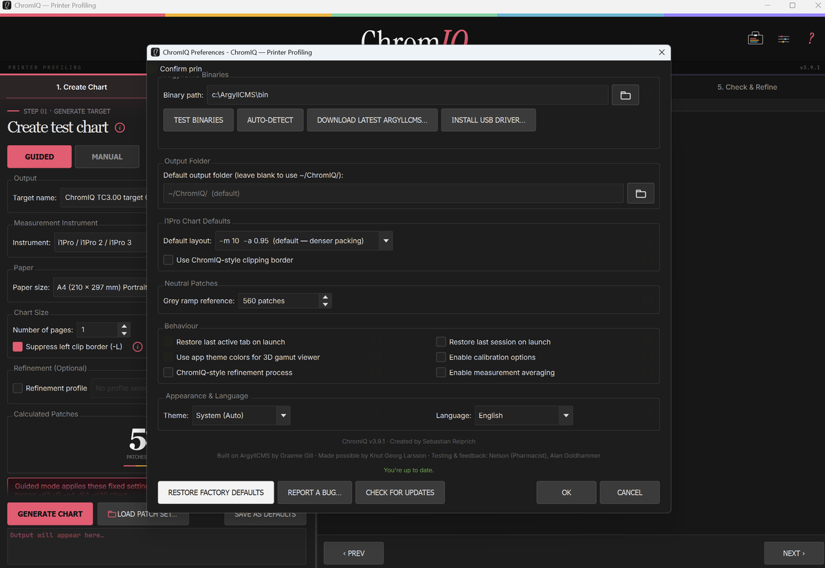

trying the dark theme, same problem and also on the upper left side o fthe preference windows I see some faulty graphical artifacts (letters unreadable/scrambled). I am using a 4K screen, so maybe it has to do with this:
My limit resets in about an hour. Then I will check on my Windows VM
Edit: The unreadable text on the top seems to be from the options that are macOS only (some of the printing stuff I tried to implement). Hope this is an easy fix because on macOS the translation works. Don't know how good it is though.
Edit 2:
Seems it found the issue. Fix will ship once the next language is added

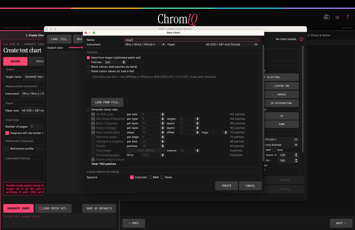

Because of a feature request from Knut I added another tool that uses spotread to make and save measurements from any surface the user wants. Each press of the button adds a measurement to the list and everything can be saved.

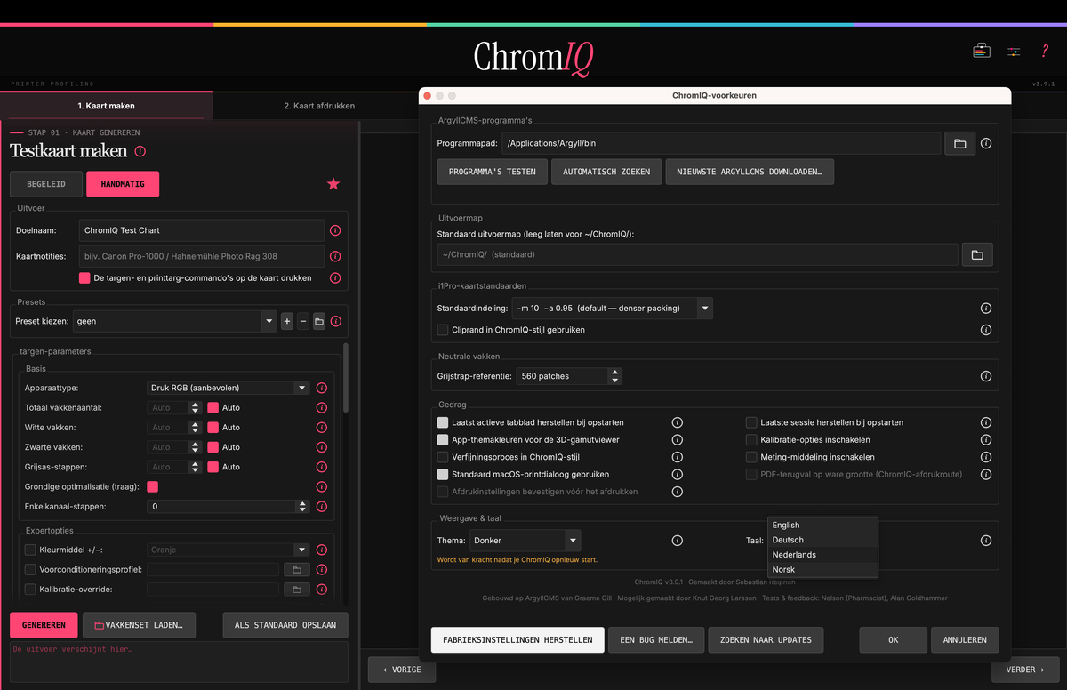

OK here is my list of strangely translated english to dutch and the improvements:
Doelnaam (target name): profielnaam
kaartnotities (chart notes): testkaartnotities
apparaattype (device type): kleurruimte
totaal vakkenaantal (total patch count): totaal aantal meetpunten
witte/zwarte vakken (white/black patches): witte/zwarte meetpunten
kleurmiddel+/- (add/remove colorant): kleurkanaal toevoegen/verwijderen
neutrale-as-stappen (neutral axis emphasis): neutrale as gradaties
neutrale-as-nadruk (neutral axis emphasis): nadruk neutrale as
schaduwgebied-nadruk (dark region emphasis): nadruk schaduwgebied
vakverdeling (patch distribution): meetpuntenverdeling
vakgrootte-schaal (patch size scale): meetveldschaal
vakvolgorde behouden (niet husselen) (preserve patch order (no randomise)): meetpuntvolgorde behouden (niet randomiseren)
z/w-tussenvakken forceren (force b&w spacers): z/w scheidingslijnen forceren
tussenvak-schaal (spacer-only scale): scheidingslijnschaal
geen tussenvlakken (no spacers): geen scheidingslijnen
gekleurde tussenvlakken forceren (force colored spacers): gekleurde scheidingslijnen forceren
vak-consistentietolerantie (patch consistency tolerance): meetpuntconsistentietolerantie
vlakken sorteren op Delta-E (sort patches by delta-E) meetpunten sorteren op delta-E
This is my first attempt to improve the sometimes strangely (literally) translated terms into (hopefully) correct dutch (Nederlands).
edit: husselen is actually a rather archaic dutch word but basically for physical objects like playing cards but not for abstract concepts like in this case: color patches for a target creation. Therefore we want to choose: randomiseren

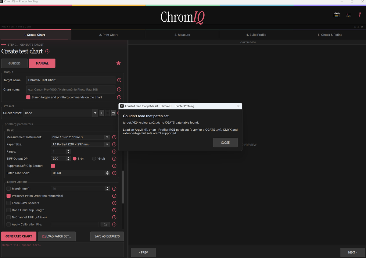

The export of that special new ti2 generator (with skin tones/near neutrals etc) does not export well, as the data lacks cgat data table information):
nevertheless the data can be virtualized in ChromIQ itself. It think it needs some tuning in order to export in cgat compatible txt format. The reason is, I want to import the data in i1profiler to see if it works.
Try save instead of export.

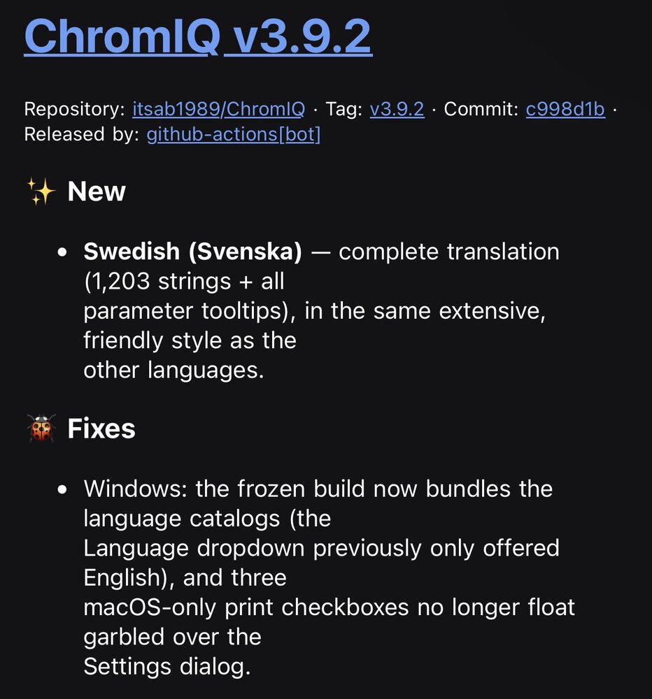

3.9.20 is online now
Edit 2:
3.9.21 now the latest
