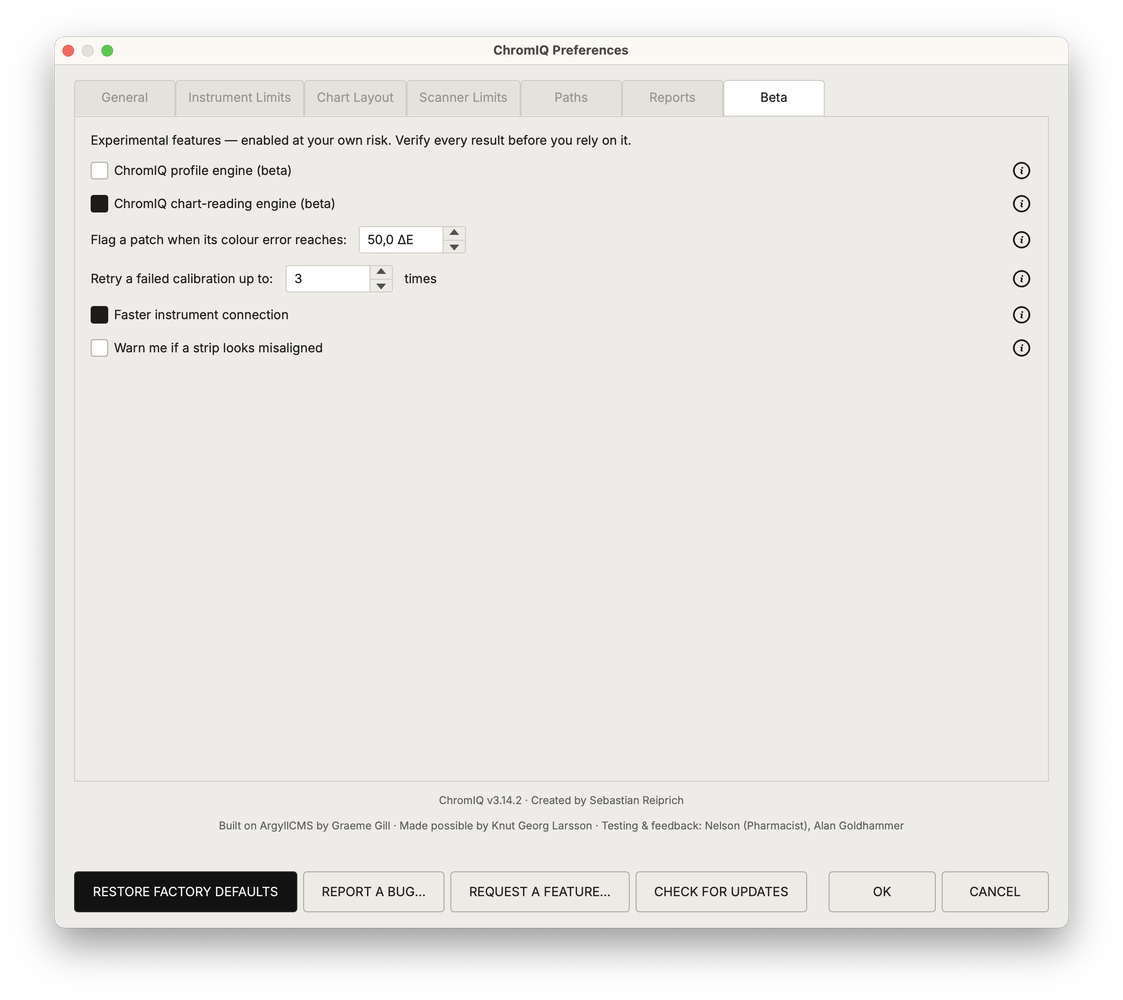

can you make 10 attempts or a value to choose to calibrate the i1pro1 instead of 3 ?
my i1pro1 lamp needs some attempt to finally burn right
It decided to add an option for you in the settings windows beta section. Give the update a while for the finishing touches though.
You can dial it up to a max of 20

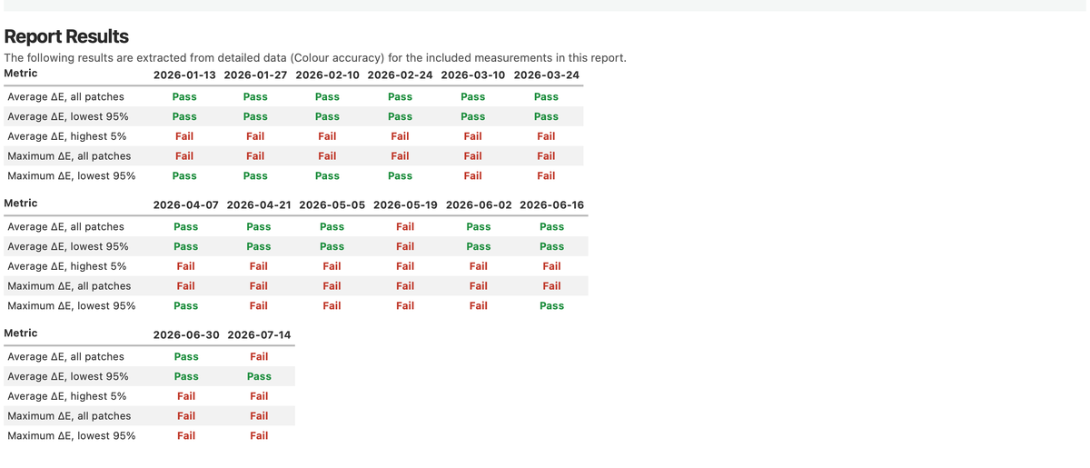

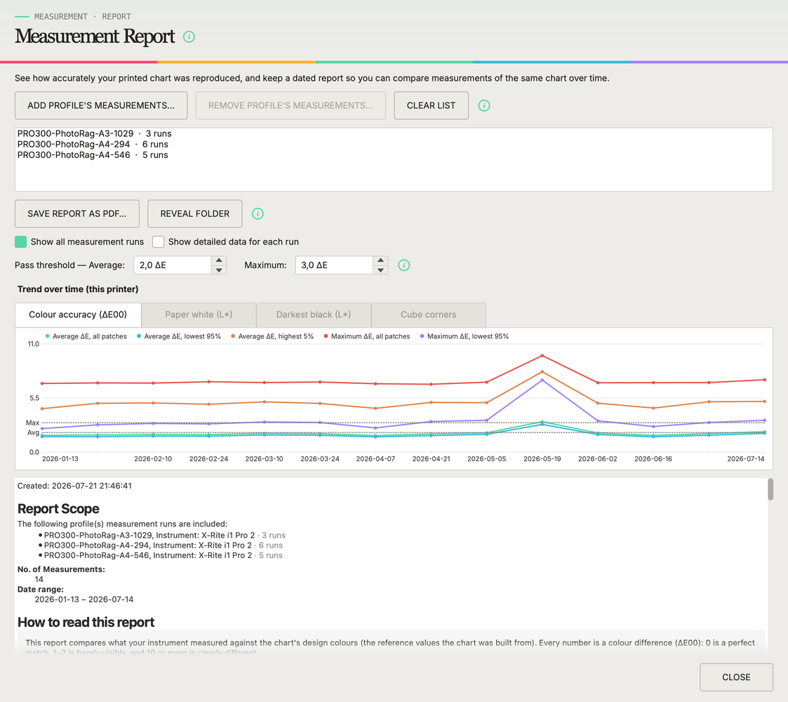

I just wanted to let you know that since the latest update v3.14.0 ChromIQ saves a small dated report every time you measure a chart, and shows them all together. So you get a history of your printer / paper that you can look at if something seems to feel off.
This was Knut's idea and he tested it extensively.
You find it in the tools menu.
There are 4 trend charts: colour accuracy, paper white, darkest black, and Cube Corners.
Every measurement also gets a simple Pass/Fail against limits you set.
Look at 19 May in the example — all red, and fine again either side of it. That was a partly clogged channel. You spot it in two seconds:

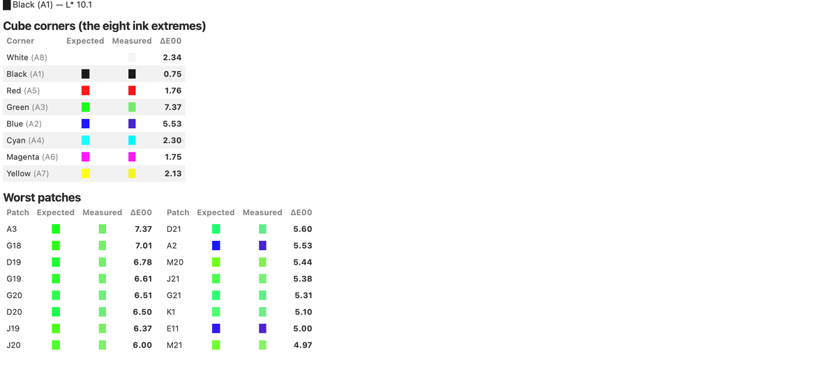

And for any single measurement you get the full detail, with the expected colour next to the measured one:
I attache the full report as a PDF and the example data if you want to click around in it yourself.
