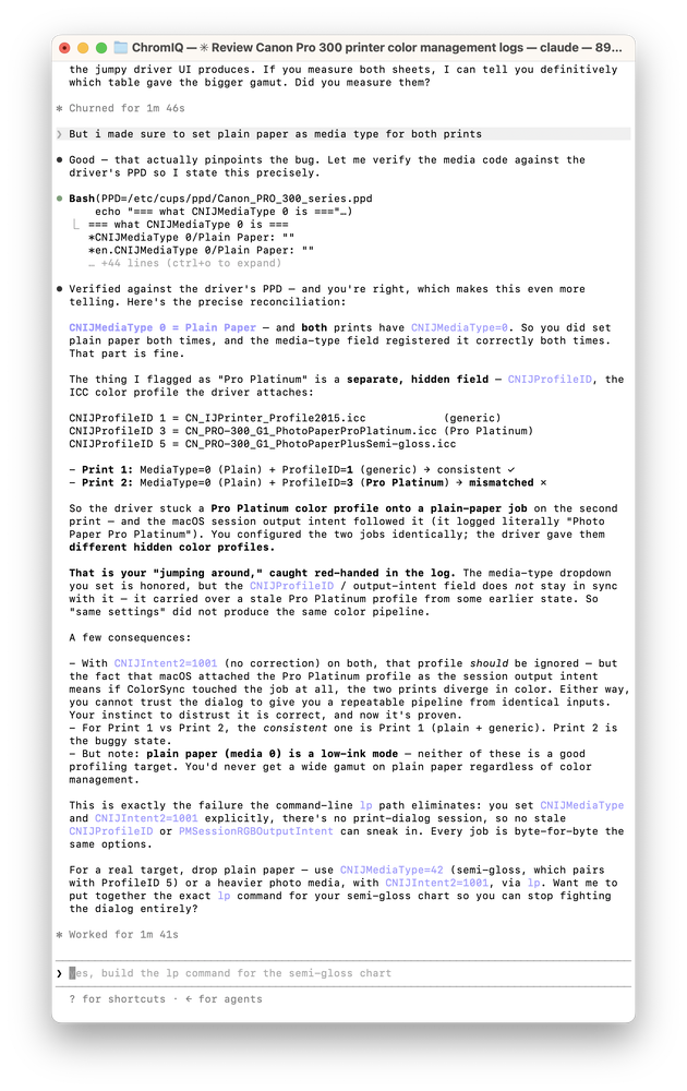

I was very careful with that and made sure to measure very slow and steady. The thing is it could also be because of some issues with turing off colormanagement during printing although I made sure everything was set to off.
Edit:
I have a feeling that it is a colormanagement issue. On friday I printed multiple versions of the same chart and could devide them into two variants: one with less contrast and saturation (looked more dull overall) and one with more saturation and contrast (darker patches were darker, lighter patches were lighter compared to the other variant). I thought the more contrasty one was wrong because macOS own Colorsync Utility specifically allows to print as a target and that print was exactly the same as the less saturated version.
A few minutes ago I printed another target. One wit the colormanagement turned off in the printer driver and one where the driver reset to the perceptual mode. This time the perceptual one was the dull one. No I don't really know which is correct and whether the driver even reliably respects the settings I make...

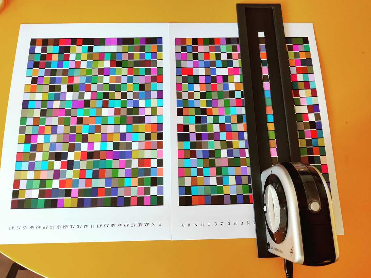

Edit: just finished my scanning of the TC9.24 with my i1Studio (2 sheets of A4):

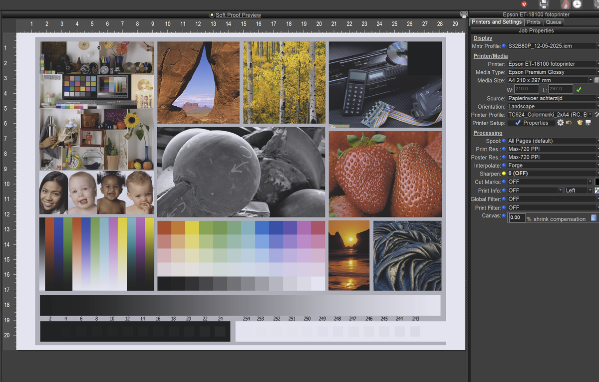

This is the softproofing:
Seems to be legit to me
Another softproofing:
Perfect profile to my eyes: not strange banding (reading errors).
This is the same modus operandi as your A3 version with the Colormunki, but on 2 sheets of A4: as you can see this test target is a bit too narrow as you can see the adjacent colours, but scanning was succesful.

I just turned off my computer. Will check this later. After a lot of struggle I managed to send an email to the Canon support with my (Claudes) findings and attached a video where I show the driver behaviour with different apps. Hope they have a look at this.
I have a Windows VM for developing so maybe you are right and I should give this a try. It is a shame that I am developing this mainly on a mac and now it is working better on Windows…
