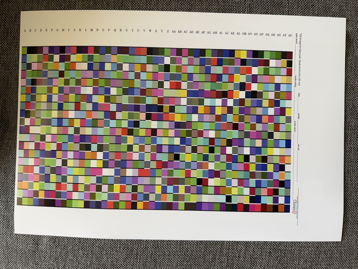

OK here it is:
I have compress the whole TC9.24 (slightly modified TC9.18 target with 3 extra blacks + 3 extra whites) on a single sheet of A3. The target can be scanned with both the Colormunki/i1Studio as well as the i1Pro1/2/3 (turn around 90 degrees). Above you can see I have done test printing on normal paper (A3) and see if it can be scanned (no strange arrow deformations). Hopefully it will do a better job than the canned Canon profile you are using now.
  • TC924_A3_Colormunki.zip

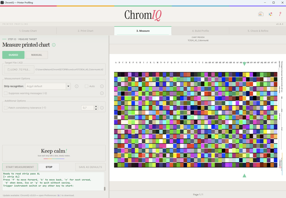

I have added it to the app and the update is on its way. Will try it after it is online.

Just printed it and will do the measurement once it is dryed. It’s a little embarrassing but this will be the first time I will actually use my own app for a real profile and not just for testing.

I just measured the target I printed this morning and the result is pretty poor. First issue was that the patches are smaller than the opening of my guide for the i1Studio. So maybe this is the issue here. Look at the comparison between the Epson ET8550 and Canon Pro 300 on the exact same paper. The Canon should be better but it falls behind.
