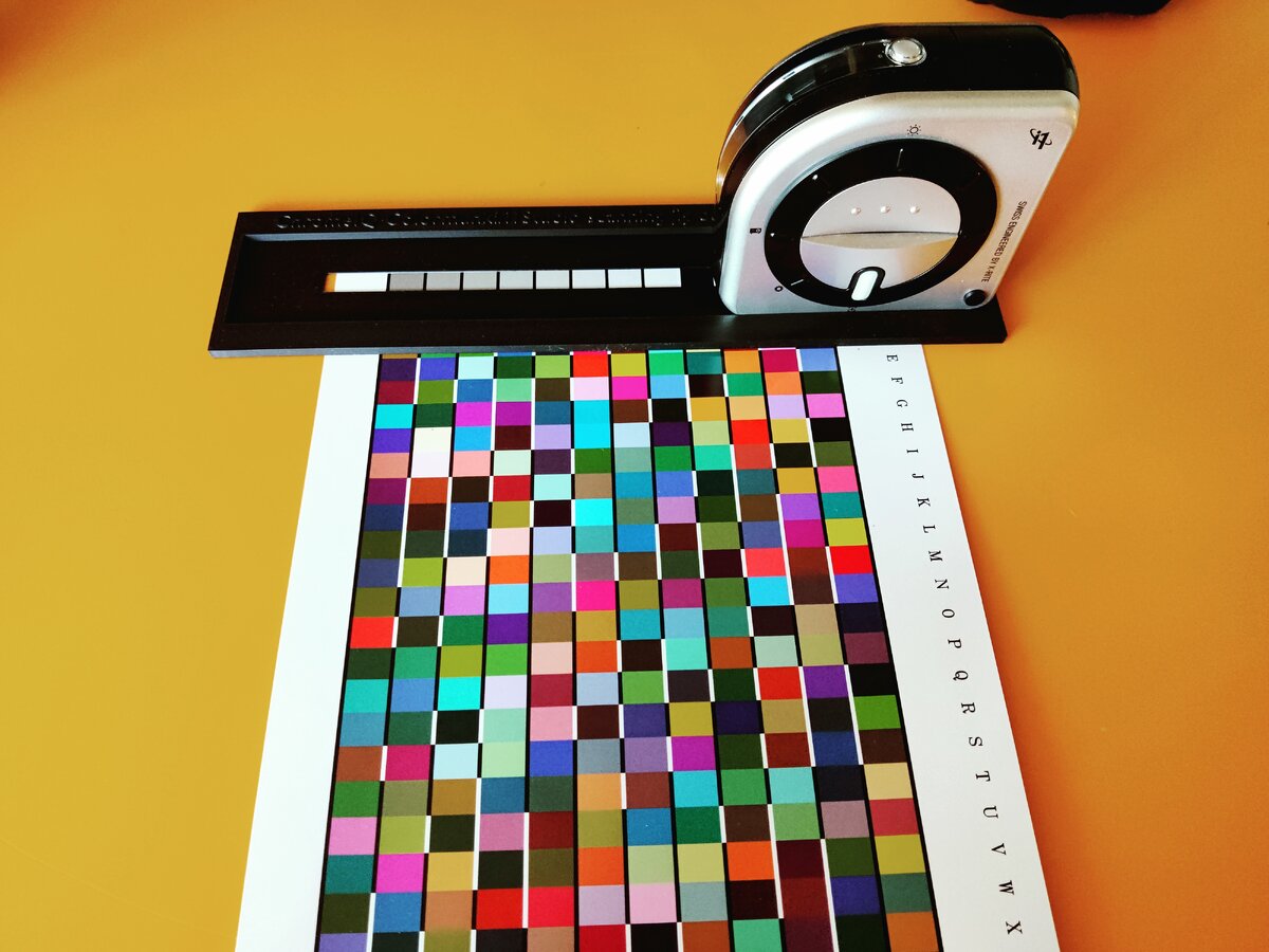

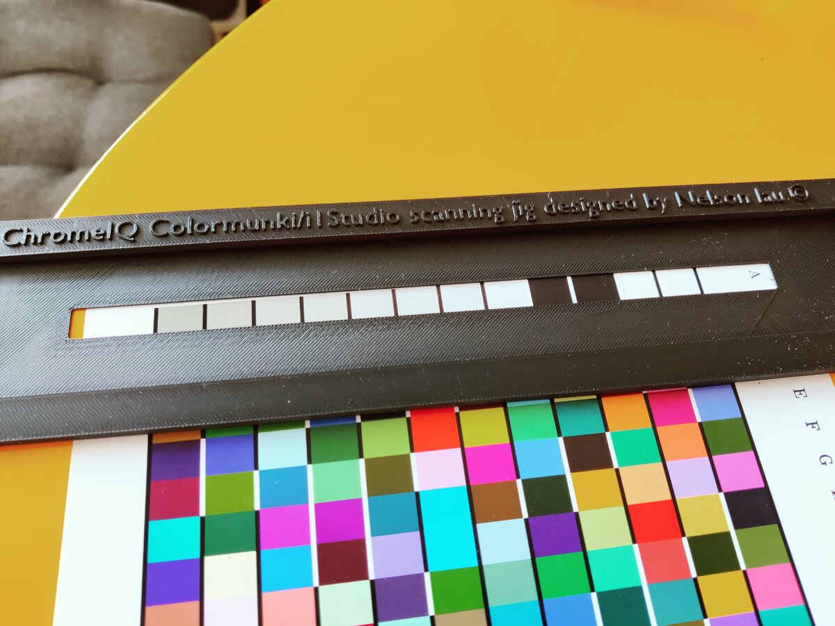

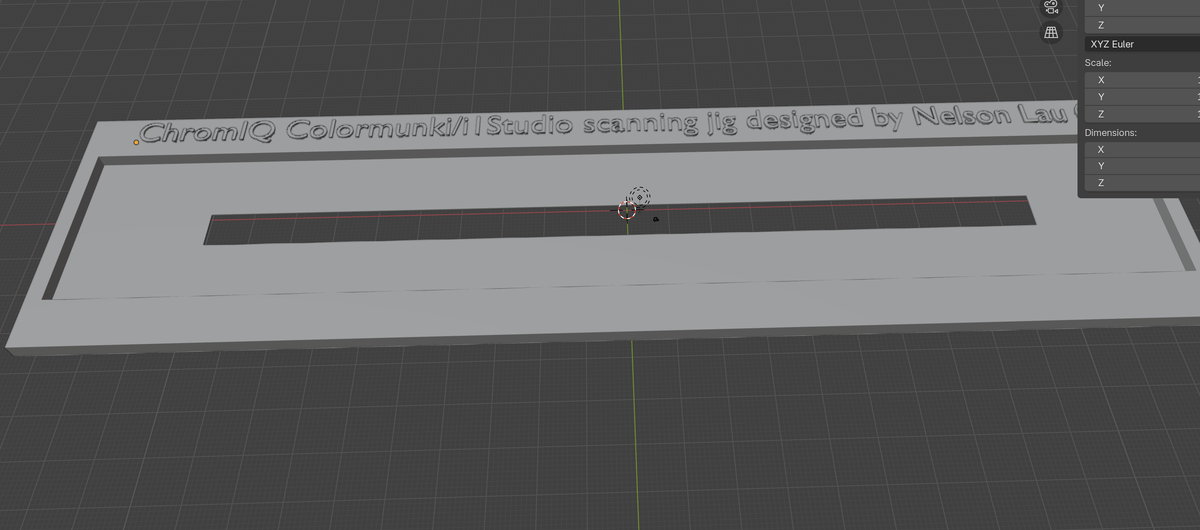

I just finished printing my special ChromeIQ Colormunki/i1Studio scanning jig:
It is for Landscape scanning of A4/Letter and can be easily printed on a standard 3D printer and is light and sturdy.
If interested I can upload the stl-file.

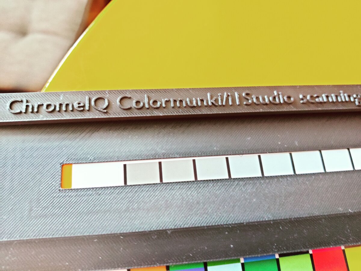

Nice! You even added the name on it! The „e“ is extra though ;)
3,119
1,808
333
SC-900 ET-8550 WF-7840 TS705
Oh that is just a cosmetic fault, Can be easily corrected :lol:
