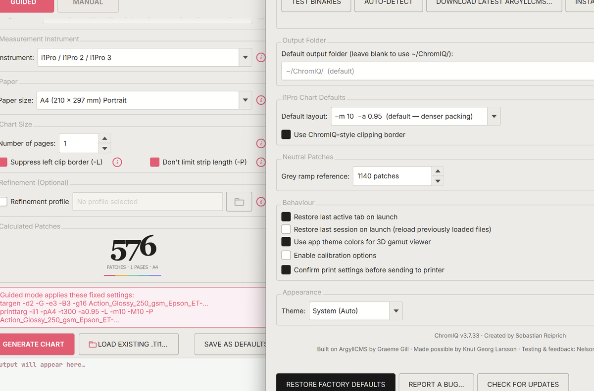

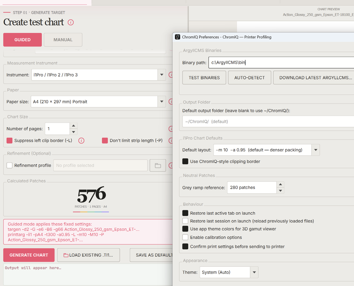

I don't understand this for the guided mode:

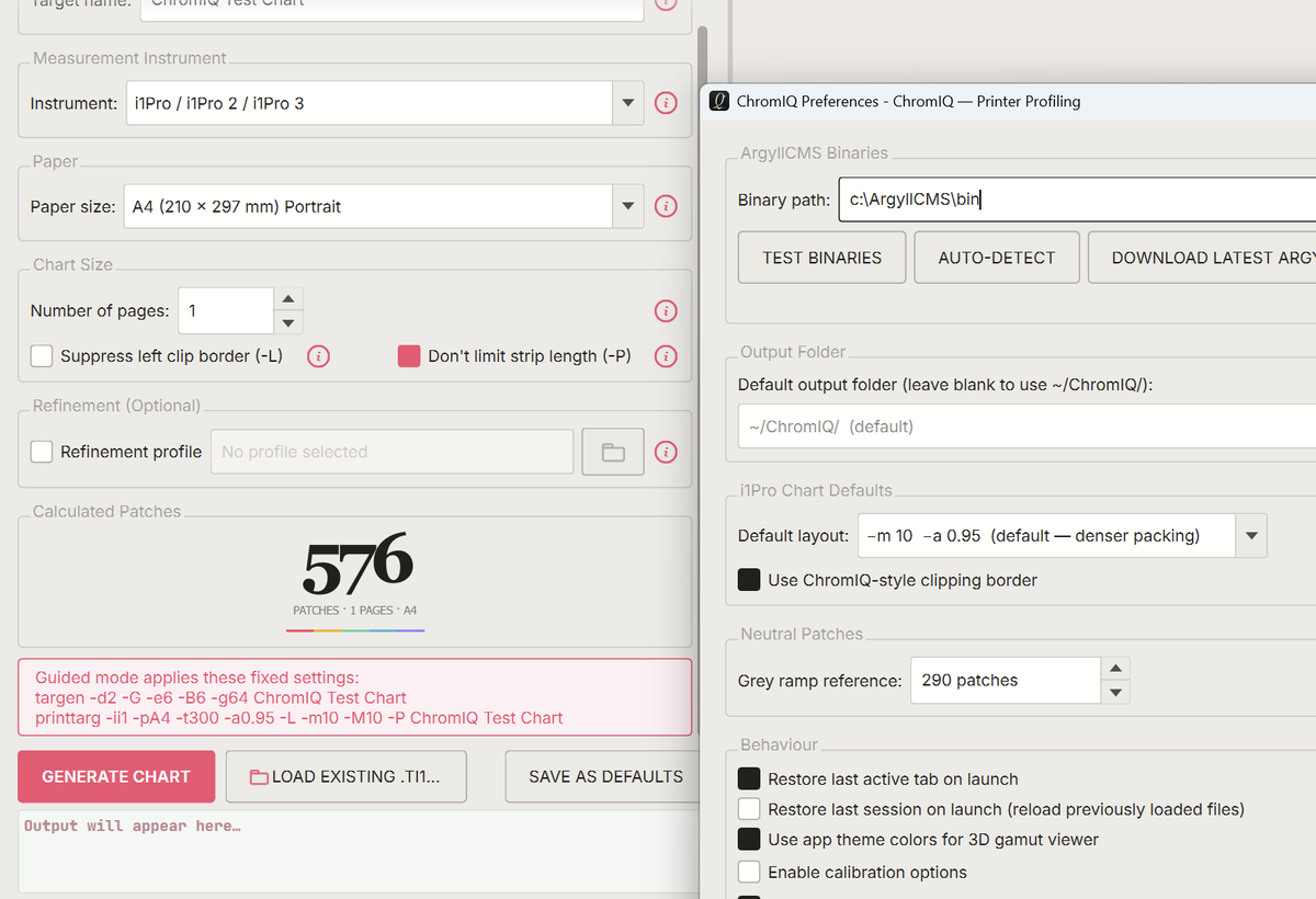

I choose for grey ramp reference: 290 patches and get: targen -d2 -G -e6 -B6 -g64
Increasing the amount to 1140 for the "grey ramp reference":
I choose for grey ramp reference: 1140 patches and get: targen -d2 -G -e6 -B6 -g16
So I think the formula should be inversed: now the amount of greys DECREASES with total patch count instead of increasing, which is weird.
Of course the amount grey steps for the Colormunki/i1Studio should be reduced significantly to maybe about 8 grey steps.

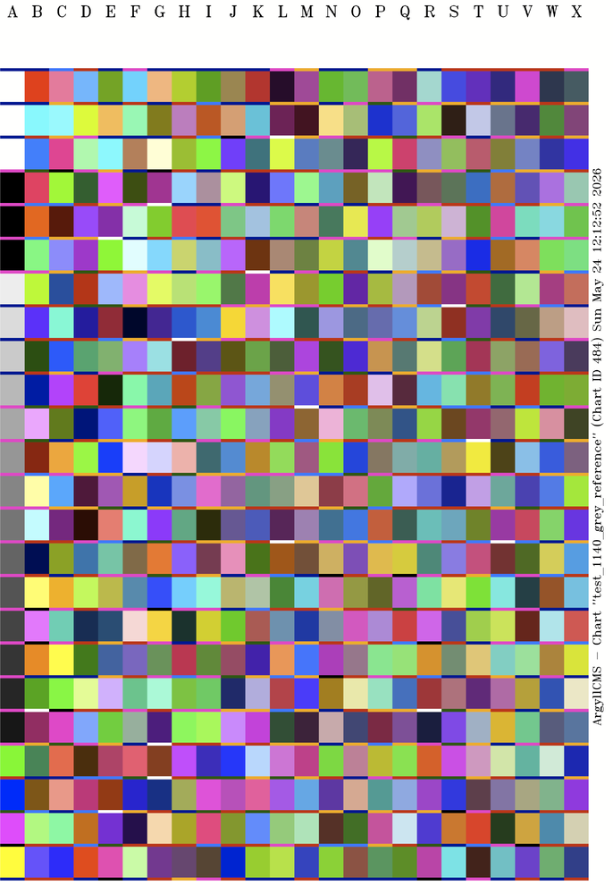

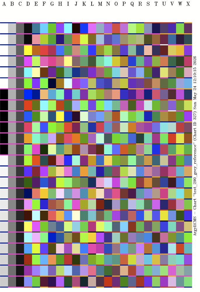

I will have a look at the programmed generated ti1 files and use manual printtarg to see how the finally tif files look like without scrambling: this way the white/black/grey patches will be put on the first rows and we can count.
Let's have a look:
With the grey ramp reference: 1140 patches we get this (1 page A4: 576 patches):
With the grey ramp reference: 290 patches we get this (1 page A4: 576 patches):
You see the amount of grey steps with the lower grey ramp reference produces MORE grey steps.
