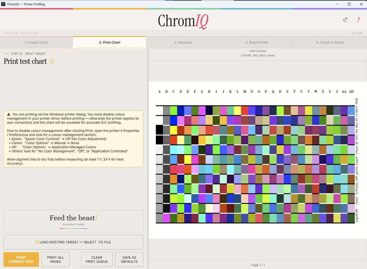

I have to retry my Colormunki method again: the profile looks horrible and I think this is causing my problem. One moment....
3,230
1,847
333
SC-900 ET-8550 +18100 WF-7840
OK giving a try with this layout (336) Colormunki.i1Studio (triple density)
3,230
1,847
333
Finger crossed: succesfully read the optimized target (with the previous profiles as preconditioning):
I really hope it is working. You have a really good hand for finding bugs by the way :D
It stresses me out everytime but I think we have fixed a good number already :)
But if you want to do pre-conditioning please update the app first. I see you are at 3.7.27 and the fixes were implemented later. Sorry for pushing so many updates btw.
