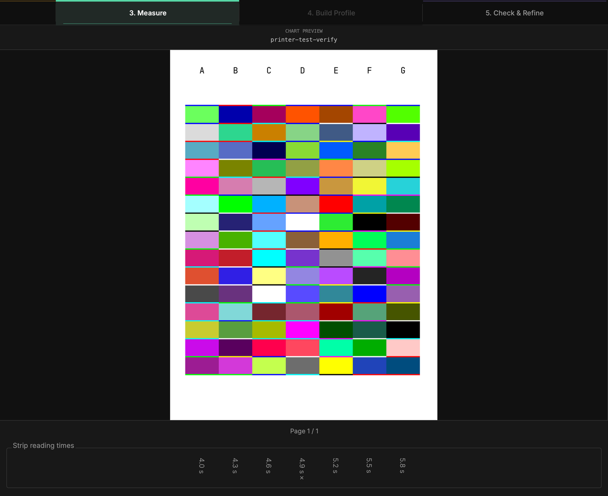

I had the same thought reagarding showing this patch overlays when a ti3 file is available and you want to remeasure a chart. Once a ti3 is available this should even work for regular chartread. However I have tied those new viewing options to the new engine.
perfect
More for me for later as a space to save my thoughts: When a ti3 is already available for a chart you want to measure in the measure tab this is recognized by ChromIQ anyway and you get an additional option to re-measure the chart instead of starting from scratch (I don’t know the exact name for this option and I am on my phone at the moment but I guess it is the refinement measurement or something).
I think it should bo possible to add another option in a similar way that allows you to show the overlay based of the ti3 that is available.
again perfect, i think that if i reload a profile and go to the measure chart and it found a ti3 file, it should shows it directly, but if you prefer an option is the same

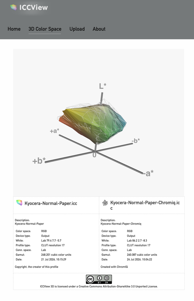

- in the gamut analisys is possible to rotate the shape, but when i compare two profiles if i rotate one of the shape and switch on the other one it will show from the starting position, if i come back to the other one (that i had rotated) it shows again in the starting position, in this way i can't switch between them to see the differences
i attach the two profile i built with Argyll chartread and Chromiq chartread (this one has lower delta-e error)

ok now it shows the previously scanned patches, it is perfect

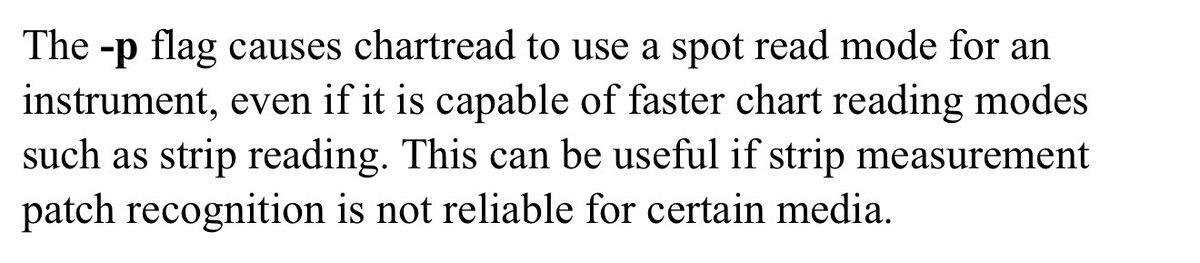

another good feature would be the fact of choosing with the mouse a single patch and make a spotread (like argyll tool) to read just the single patch several times and than average the values got, always if possible, so one can reread only the highest Delta-E patches.
Thinking about this I figured that chartread already offers a patch by patch mode with the -p option.
This is also available in the measure tabs manual module for the user to select.
Actually earlier this week I tried this out the first time myself because I wanted to check how the selection and overlay are working in the measure engine. After implementing some fixes it basically works as you describe and one can simply click any patch on the chart and it gets selected as the one the user should measure.
2 things though that I don’t know:
1. if you can read the whole chart like you would always do in regular strip mode and then only for remeasuring enable patch by patch for single patches - that part you could simply try
2. the averaging part. I am not sure if this mode takes only a single reading for every patch or if it takes multiple readings like in strip mode and then averages them. I would have to ask Claude about this
