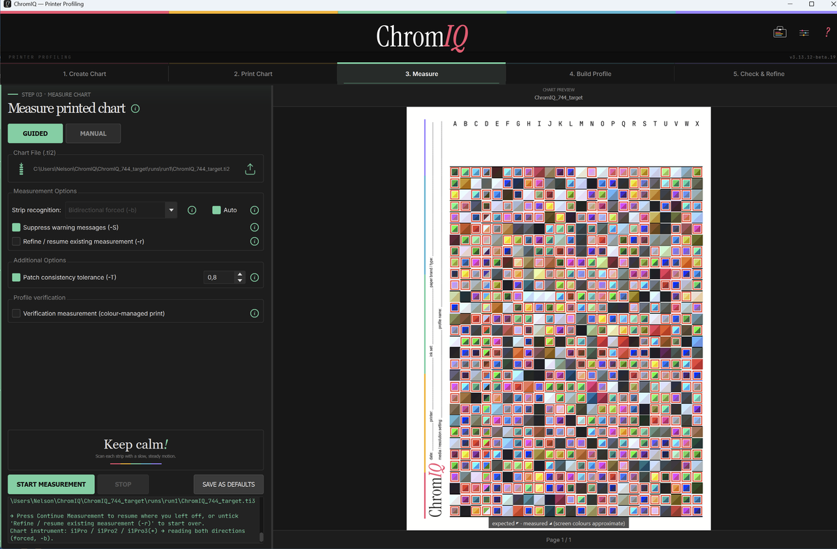

I know you want to use i1Profiler. But since you are on Windows could you try to start a measurement inside ChromIQ with the new option I mentioned enabled and tell me whether it works and you notice any speed improvements?

with the new option enabled the scan seems to succeed succesfully:

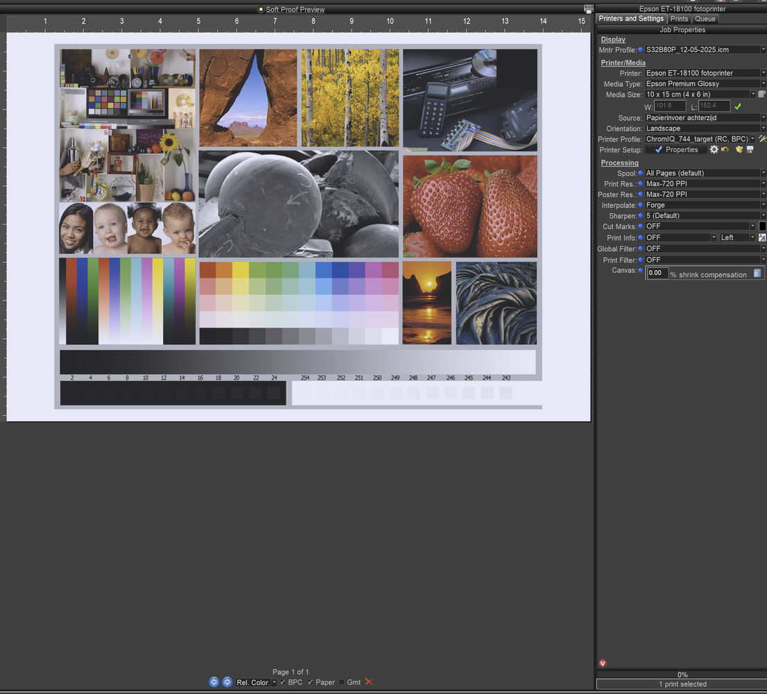

However there are a lot of pathches highlighted (standard setting: Delta-E: 20), maybe I should increase it a bit: not sure how the engine decides whether or not a patch is highlighted or not, but the softproofing seems to be very good (744 patches):

I will give this feedback right back to claude. Did you notice a speedup with the calibration pop up window?

very strange, this should be visible in the softproofing by strange colour pike in the colour gradients. I don't see anything strange and the softproofing is very smooth and no strange colour spikes.
I also see the strange expected/measured values in row D:
But it doesn't translate at all in a faulty or strangely behaving target: it is perfect for the given paper/ink/printer combination. Could it be a bug ?
Here is the ti2/ti3 combo, so maybe Claude can have a look at and why ChromIQ shows those strange offset colours.
